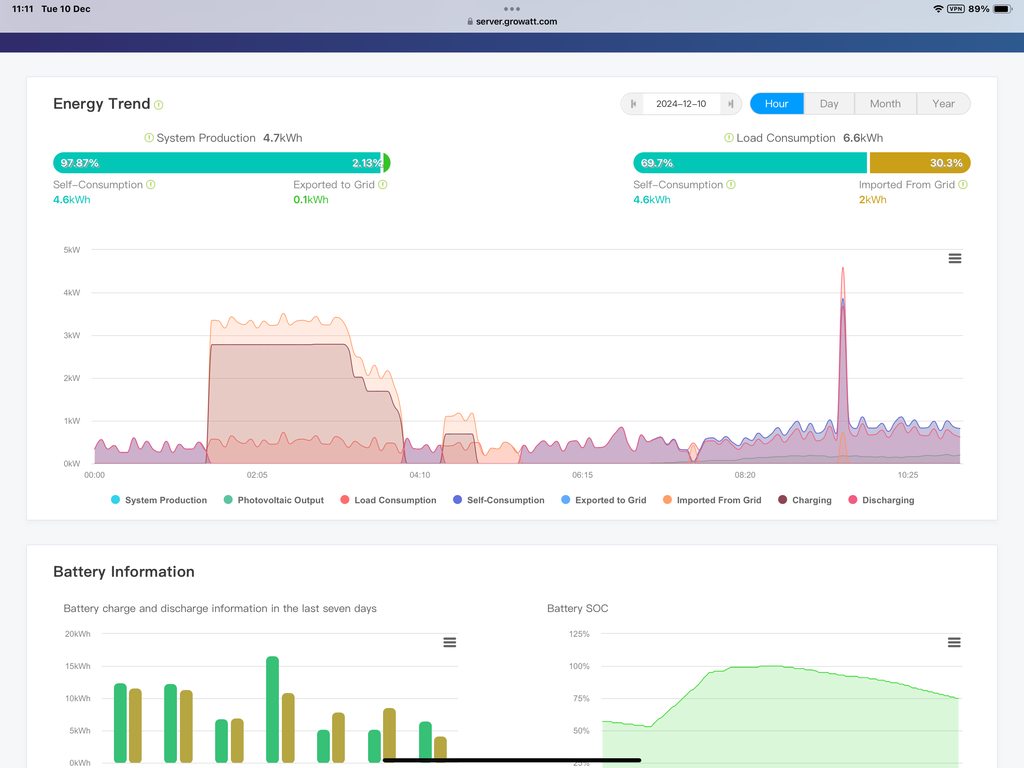

ALLENPATTRICK 0400 - 0430

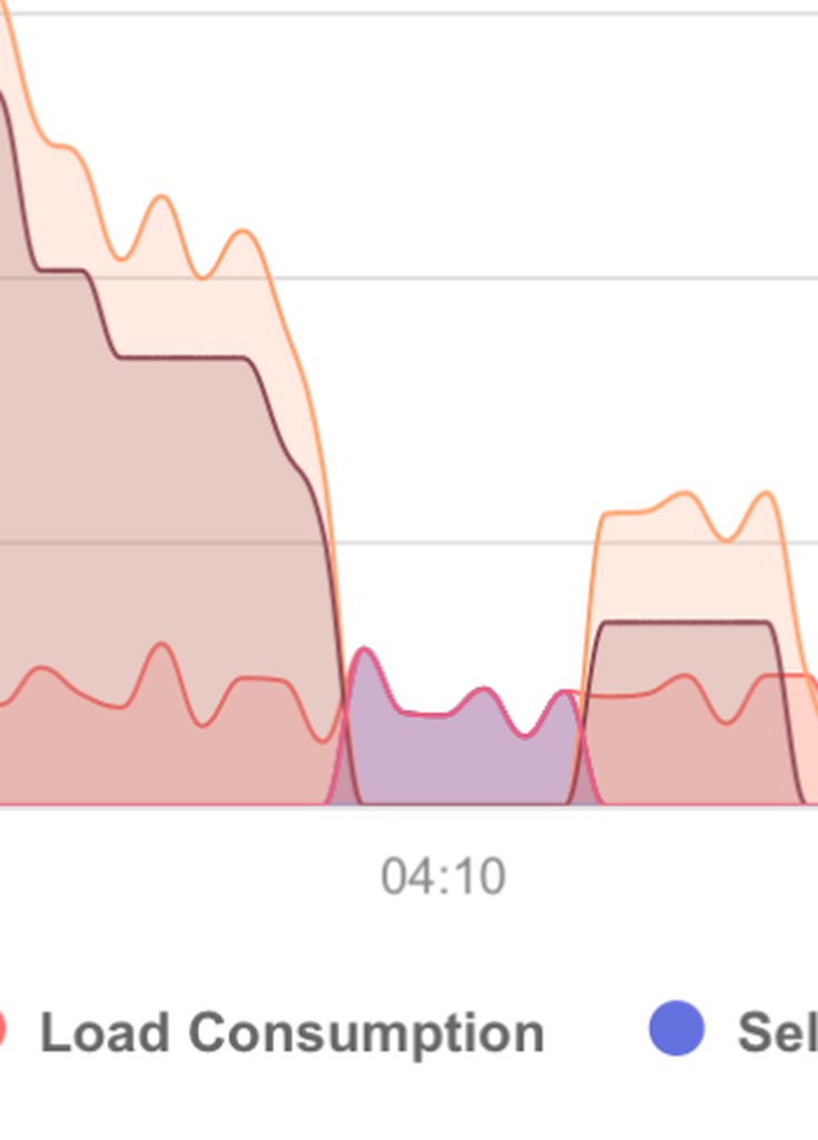

Battery stayed at 99% throughout and energy drawn from Grid
This was only half an hour usage. We stopped the charge slot at 4:01, see here:

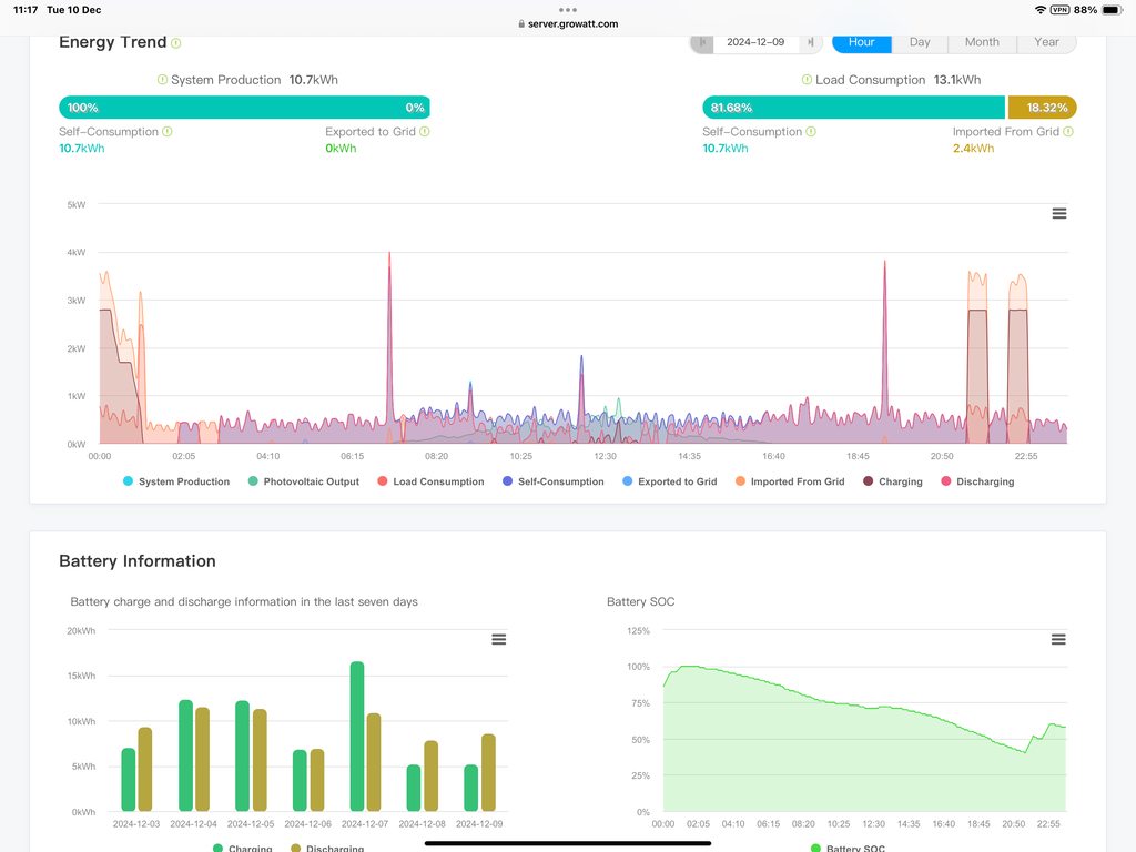

Now, unless you are drawing huge amounts of energy from 04:00-04:30, I wouldn't expect your battery to drop significantly at a nightly draw of 200-300W or such for 30 mins. Please check the Energy Trend graph in Growatt and show us that please, it should indeed show that the battery was used between 4 and 4:30.
You had an agile charge slot active from 4:30 to 6:00. Because the SOC of 99% is less than 100%, this charge slot was actioned.

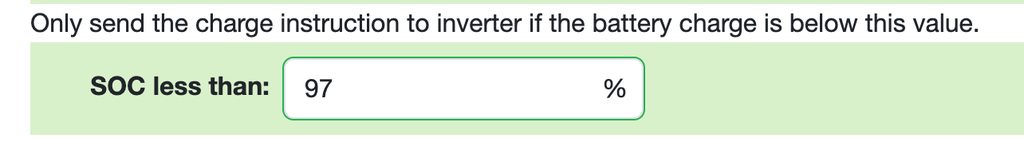

If you want to use the battery in slots like these, you probably should lower your 'SOC less than' value in your Agile charge window to something like 98 or 97%.
