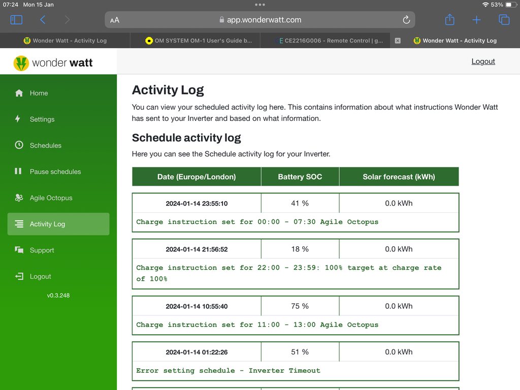

I set a standard timed schedule last night to charge from 10pm to Midnight as I wasn’t sure if I could set multiple agile sessions that spanned 2 days.
The Agile session was then set to charge from midnight to 07:30

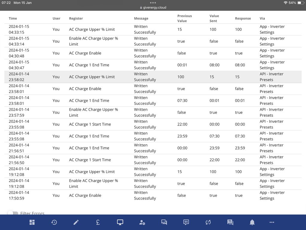

I woke up early this morning and found the system not charging.

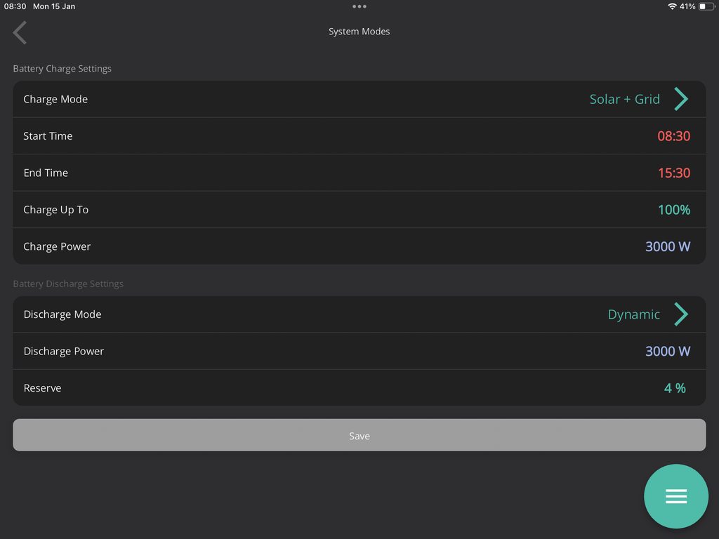

The settings had changed from charge from grid and solar to just solar and the max charge to 15%
Is this a bug ?
I have set the agile process to charge today up to peak time and this as been scheduled correctly
Was the glitch something to do with a standard schedule being set prior to the agile session being delivered ?
