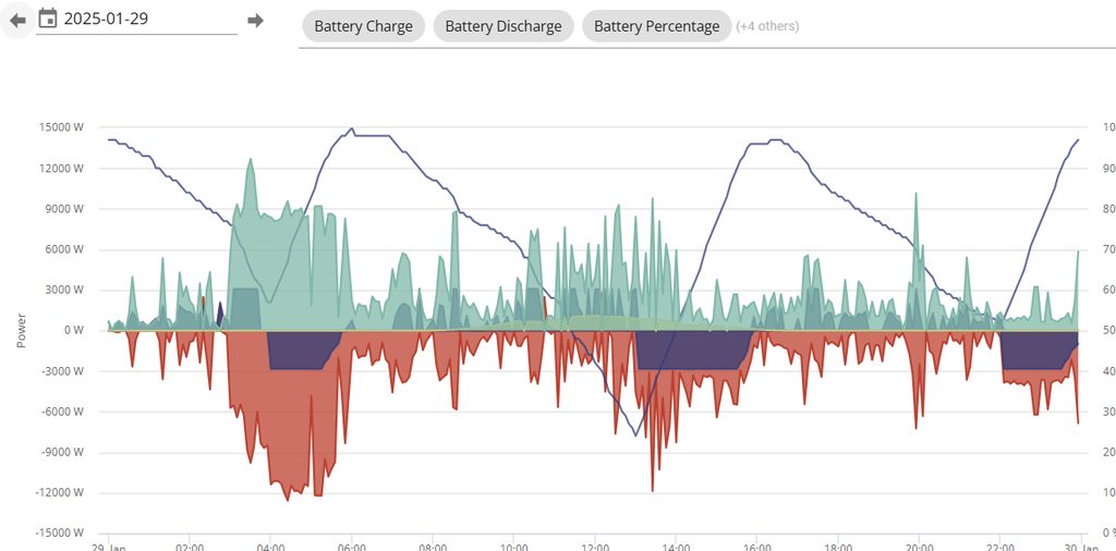

I'm using WW to charge my battery during the cheap periods on Octopus Cosy (4-7am, 1pm-4pm, 10pm-12am) and then switch to Eco mode outside of those hours, in particular during peak period (4pm-7pm) in order to minimise costs.

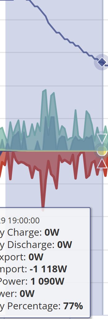

Generally the battery is pretty close to 100% by the time 4pm comes around, and then I do indeed see the battery picking up some of the load at 4pm. However, it doesn't fully use the battery during this time
eg
zooming in on 4pm-7pm, you can see that about 2/3 of the load was picked up by the battery, but there was plenty of capacity.

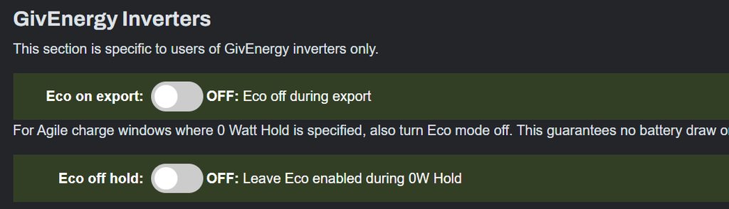

I'm wondering if a discharge schedule would be the right approach? On the advanced panel I also see:
but I didn't yet figure out what they are for or if they are relevant?
