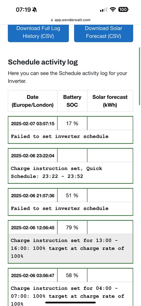

mickgrieve Just wondering if there are any known issues this morning. My batteries failed to do a scheduled charge last night. I noticed at half 11 that the batteries were not charging so I was able to do a quick charged for the last half hour of the cosy cheap rate.

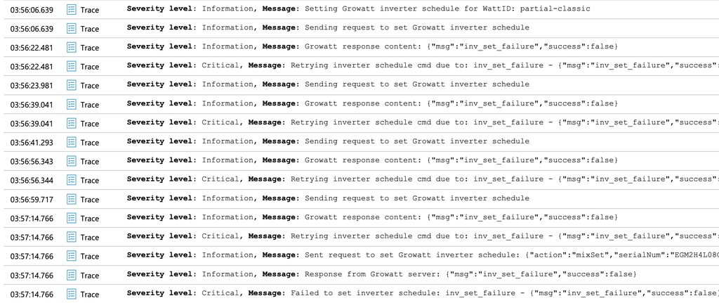

admin mickgrieve Managed to locate your account, but easier when you specify your WattID. Looks we got an error message back from Growatt, some sort of comms issue it looks like, see our logs and Growatt error responses.
