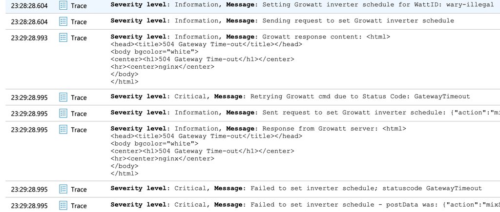

However now ive signed up for a years subscription, last night i had my first impactful failure. there was repeated failure to communicate with inverter to set charging on my battery from 23:30 to 05:30 🇦
2025-02-24 23:35:39 35 %
Failed to set inverter schedule
2025-02-24 23:33:53 35 %
2025-02-24 23:29:29 35 %
2025-02-24 23:16:03 35 % 15.4 kWh
Failed to set inverter schedule for export to grid.
This meant the battery didnt charge during IOG cheap time and battery had completely discharged overnight.

Is there anything that could be done to lock in a 23:30 to 05:30 slot ? if WW only uses slot 3 for its variable updates, could we have a permanent 23:30 to 05:30 in another slot and then never update to overlap timeslots - if a user did a manual charge/discharge etc then it could wipe the other slot and return it the next day or similar.
Is there anything i can do to help avoid what happened last night? I think losing the overnight charge will have cost me more than any savings ive made so far using WW.
