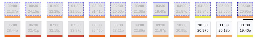

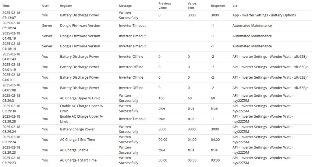

I had a problem with the end of hold overnight where the discharge current wasn't reset back to 3KW.
The charge at 3.30am worked correctly. The revert to hold at 4am met with 4 timeouts in a row. This didn't actually matter as the discharge current register was already at 0. At 6am when the hold slots ended WW should have reset the discharge current back to max. No command was sent probably as a result of the timeouts even though it would probably have got through. I reset it myself at 7.13am.
Please can you take a look. Logs below.
