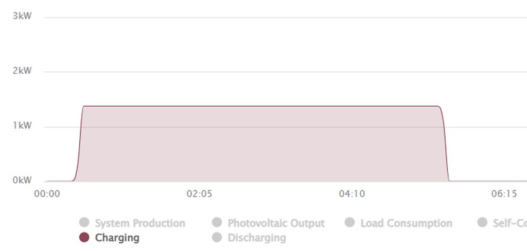

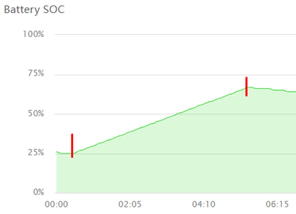

In a charge schedule I enabled the "Auto charge rate" option rather than set it to 100% as thought it would be kinder on my 13kWh Growatt battery stack. The target SoC target was 100% over a 5 hour charge period.
However, it got nowhere close to fully charging my batteries. As below just charged at a constant lower rate (the batteries can charge at 3kWh). I thought that the auto charge rate would be adaptive and increase charge to make sure it reached the set SoC target by the end of the charging schedule?
