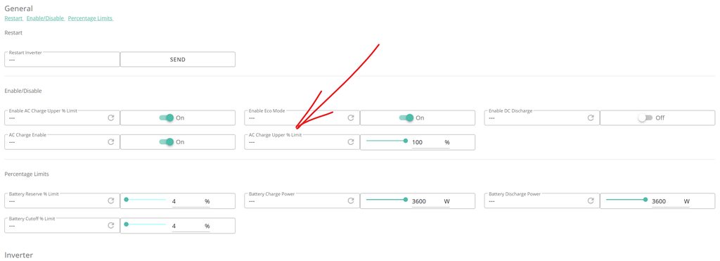

Hi Wim @admin, I hope that you are well, it has been a while - sorry there has been a lot going on. I have mentioned this previously but during the winter when I was using all of my AIO it wasn't a problem, but now as we move to the warmer months, my desired value is now more relevant.

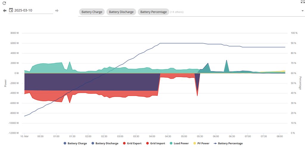

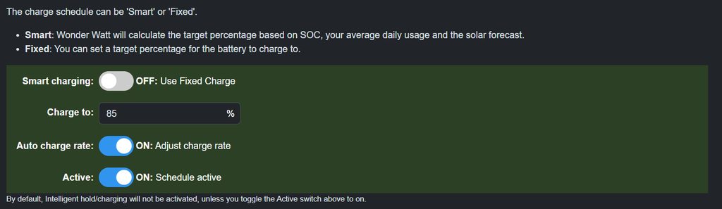

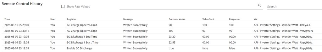

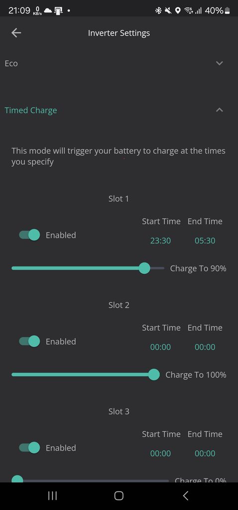

Unfortunately, whatever value I set this to, the AIO charges to 100% SoC rather than the desired value - in my case 85%

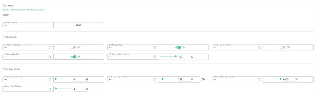

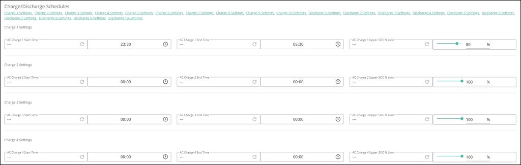

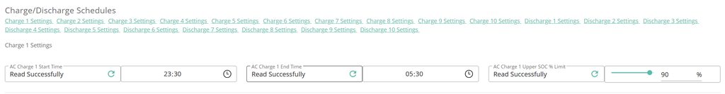

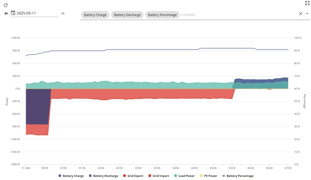

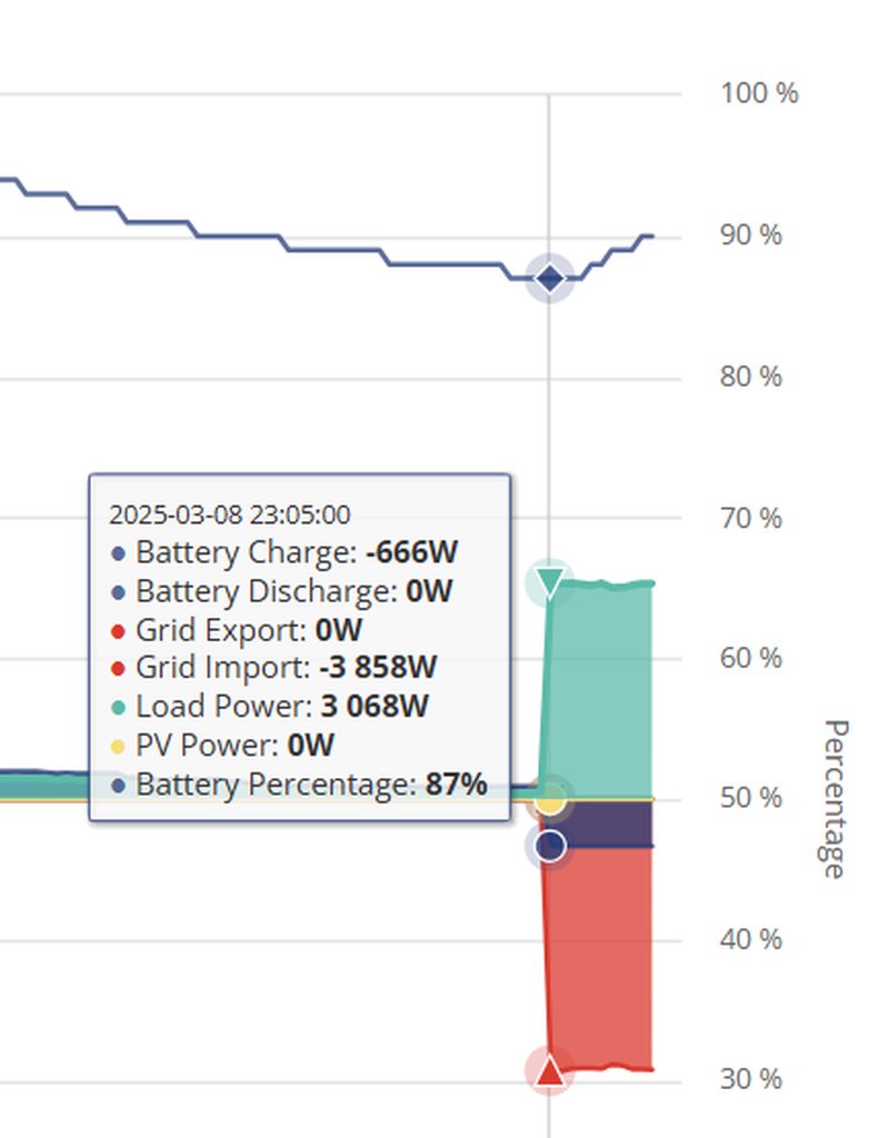

I can see in my invertor logs, however, that WW is setting both the Enable AC Charge Upper % Limit to True and the value of AC Charge Upper % Limit to 85, so in theory, it should be all good. But every time, the AIO just blasts past this value and charges to 100%. I have also seen when it says in the logs, "Keeping battery at SOC level:88%" this is the outcome:
So, something is not quite working right with WW and GivEnergy in this regard.
