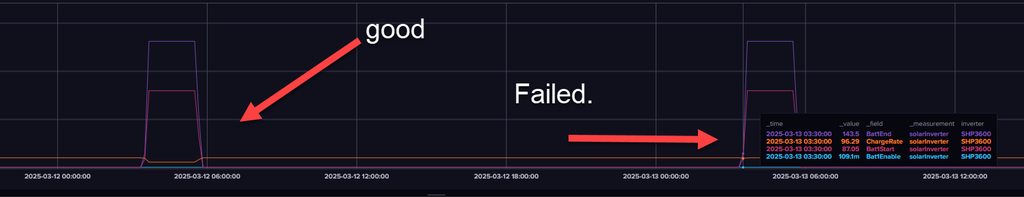

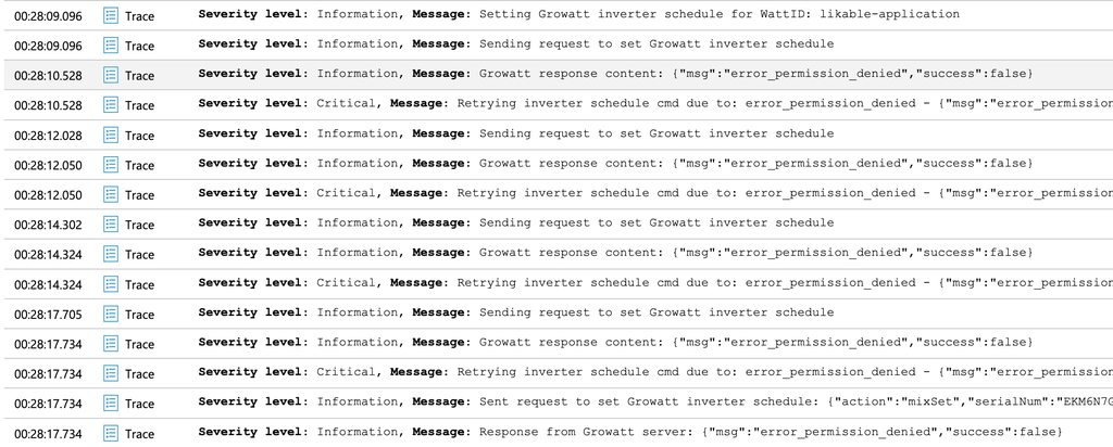

Regards above, I also had issue were the batteries failed to charge last night. I log growatt data at 10s intervals and could see that the growatt inverter received the charge start/stop instructions, however no change in battery SOC.

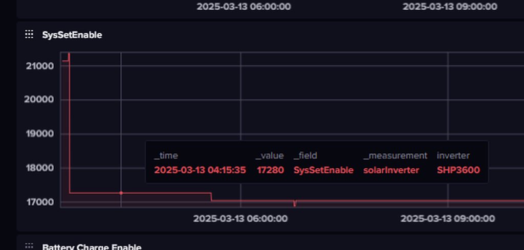

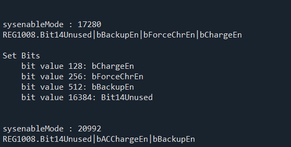

I also noticed that the sysenable mode was a value that I hadn't seen before during previous scheduled charges.
Data values and decodes from growatt MODBUS document.

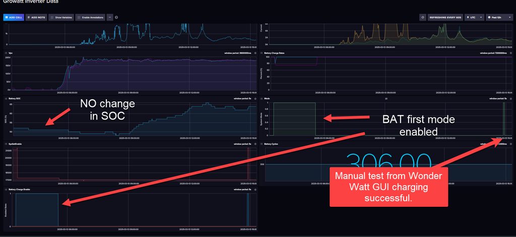

Further more I zoomed into BAT1 enable/disable/charge rate settings for the period were batteries failed to charge. I also observed that the charge rate 'jumped' to 100% shortly after starting the scheduled charging session.
NB the BAT1 start/end values when decoded give start / end times.
Growatt Gremlins at work?
