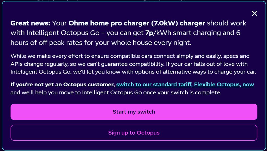

With the current pants Agile overnight rates and lots of solar PV coming up I am wondering if IOG would be a better bet for me. My daily average rate on Agile at the moment is around 18p/kWh (used to be around 9p).
I have an Ohme Pro charger and a PHV so Octopus say I can have IOG.
I also have a GE inverter (gen1), a GE battery (8.2kWh) and 4kW solar PV.
On the Octopus site it says you get 7p charge slots when charging an EV and 6 hours overnight.
How does this work in practice?

    johalareewi I don’t think it works with Ohme chargers though. WW IOG integration works if you either have an Octopus IOG compatible EV or car charger, and your mapped charges show up in the Octopus app.
    For Ohme, it looks like Ohme manages it and we cannot see any mapped slots on the Octopus side.
      admin The Ohme charger is IOG compatible according to Octopus (it was them that installed it). But if IOG is managed by the Ohme app, that is bad news. The app is dreadful and I would love to dump it and have the Ohme managed directly by Octopus.
      If WW can't see the mapped slots that is a PITA because WW won't be able to stop the GE battery emptying into the EV charger.
        johalareewi If WW can't see the mapped slots that is a PITA because WW won't be able to stop the GE battery emptying into the EV charger.
        Yep, precisely, see also recent thread here from an IOG user with Ohme, and the link on Octopus where you'd normally see mapped slots would take you to the Ohme interface. We get no IOG slots from Octopus for this user.
