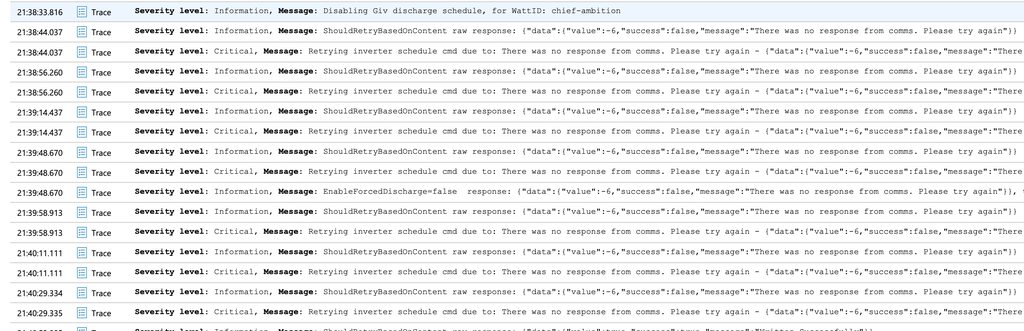

    danvoner After scheduled discharge between 20:40-21:40 last night (27/03) - it didn't change discharge to false
    Looks like comms issues - we received errors from the Giv API:
    danvoner IOG , when I unplugged my car at 06:15 this morning (28/03) it didn't send an update to stop charging from grid when the last session was originally set to 08:00
    We'll look into this and are adding some more logging to work out what's going on, thanks.
      danvoner Nope, not yet, added more logging to see if/when this happens again.
