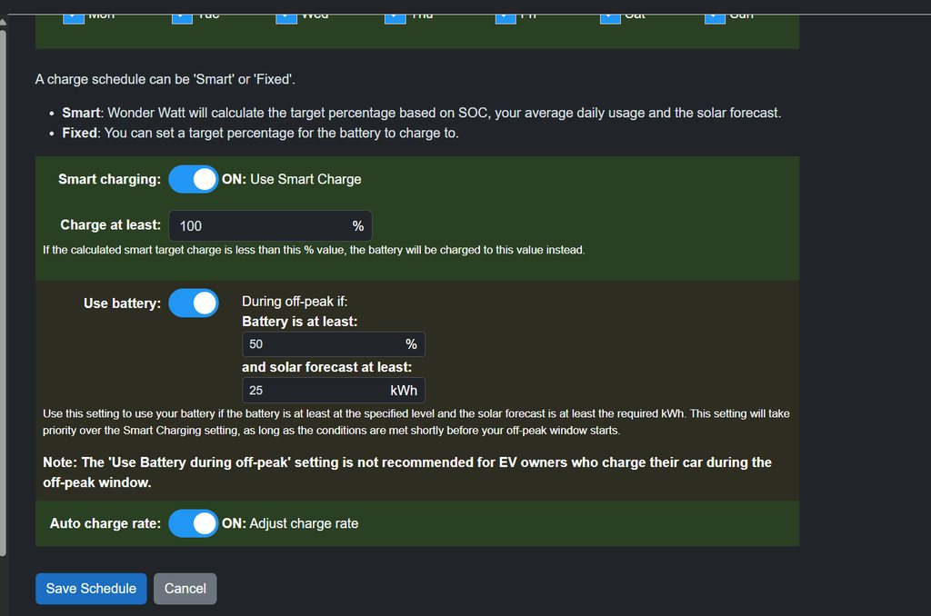

          forgetting rates for now, i amnot sure whats going on or the change I need to make, but last night my batter charged at a rate on 22% all night but was full a 01:00 and remained in charging battery even though there is 45kw of sun today.
          what I would have expected was for it not to charge over night because there is a good forecast today. what am I doing wrong or need to change. i think at 22:00 I was under 50% soc
          name is old-dust
            Robbie You have your Charge at least SOC target set to 100%, which will always override the smart SOC target WW calculates. See it as a 'min charge target at all times'.

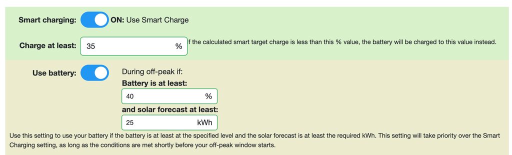

            Change to something like:
              admin Thanks, I have changed it to how you have shown, will see what that does, thanks
