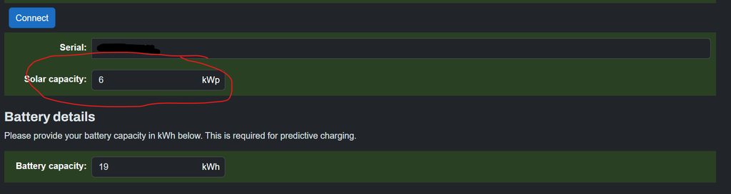

    Tailors For this section"Solar panel details" what if we have panels on the East & West facing roof, do I select South facing as that also gets sunlight all day?
    Just combine the East/West output let's say 3+3 = 6kW, and reduce by 1kW or so and specify 5kW pv for South facing. Should get you close enough to a daily estimate. You can then slighly tweak as you see the estimates come in. Though be aware this is a rough indicator.
    I've got a slightly uneven E/W array, total 7.8kWp, and have found setting the "Solar Capacity" to approx 75% of the actual gives pretty good results for summer.
    Winter is just a complete guess anyway.
