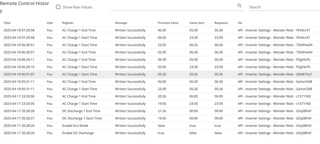

@Lins1 I note your thread starting point of 'no schedules set up in GivEnergy'. My understanding is that you have tried to discharge to the grid using both WW schedules and WW's forced export Homepage short cut.
You later mention evening charge which you report not wanting (as you believe this not to be cheap rate whereas I suspect it would be and provide by Octopus. Some refer to these as 'bonus slots'). What I don't see in the logs are any IOG instruction which surprises me? I make the assumption you have got your MCS approval to export.
