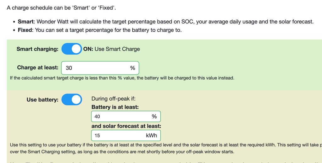

dj10gan Does the above message mean that my battery will not be used during the off peak? I would expect that minimum levels would be maintained and excess would be used on house load or exported to the grid! Am I not understanding the proper meaning? I've never seen this message before! Would you please explain what it means. Thank you. distorted-effect
admin dj10gan Change your Cozy 2 slot from Fixed charge to Smart charge (and reduce the Charge at least %), and you can also then select the option to 'Use battery during offpeak' based on SOC and Solar yield conditions. Something like this for instance:
