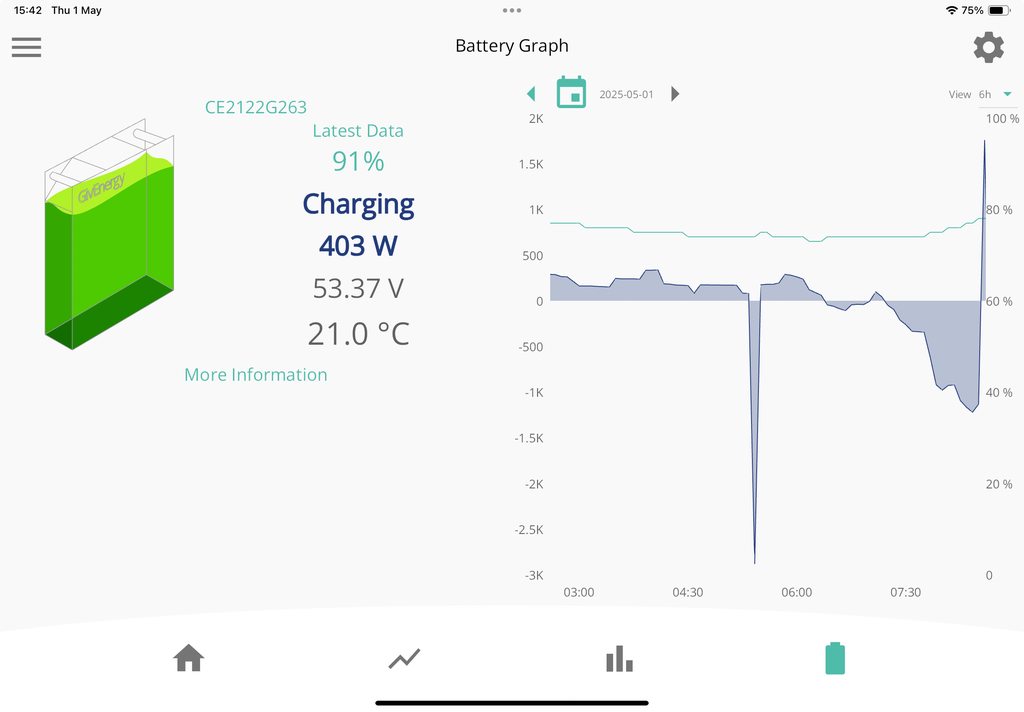

ChrisR you're on IOG right? So 05:30 would be the default switching point from the standard overnight cheap period.
Are you actually getting any consumption at this point, or is it just the graphs showing a spike at a switch in commands?
Bear in mind that the GE charts only have a 5 min resolution.
