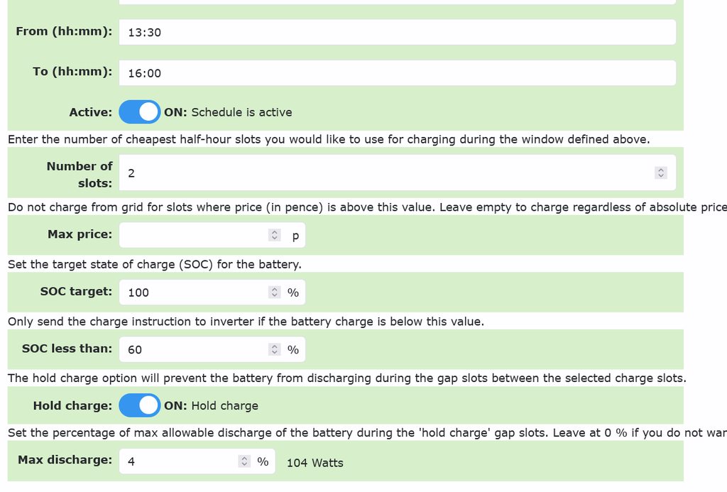

I set a hold for an Agile window. The hold shows up on the display.

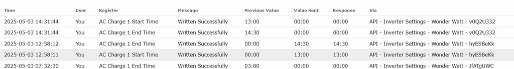

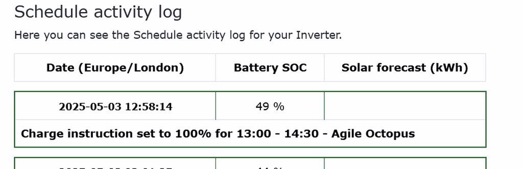

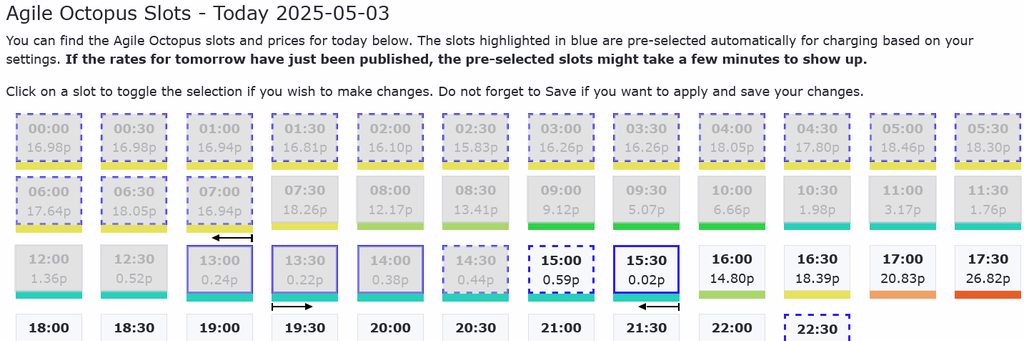

There was a charge slot before the Agile window and 2 at the start of the window.

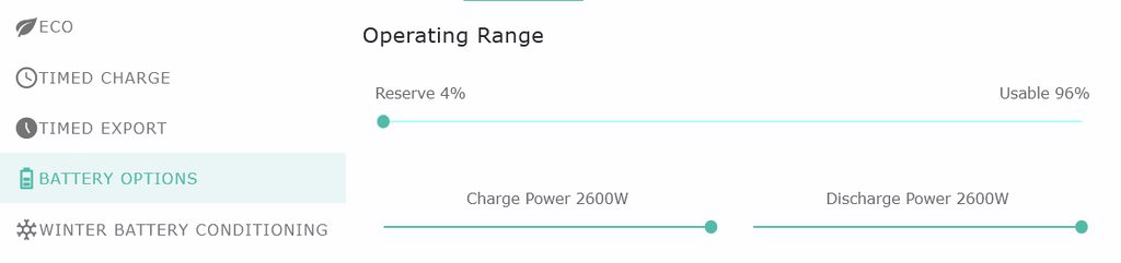

The charge instruction got sent to the inverter but at the end of the charge, the hold wasn't sent and the discharge rate remained at 2600.
