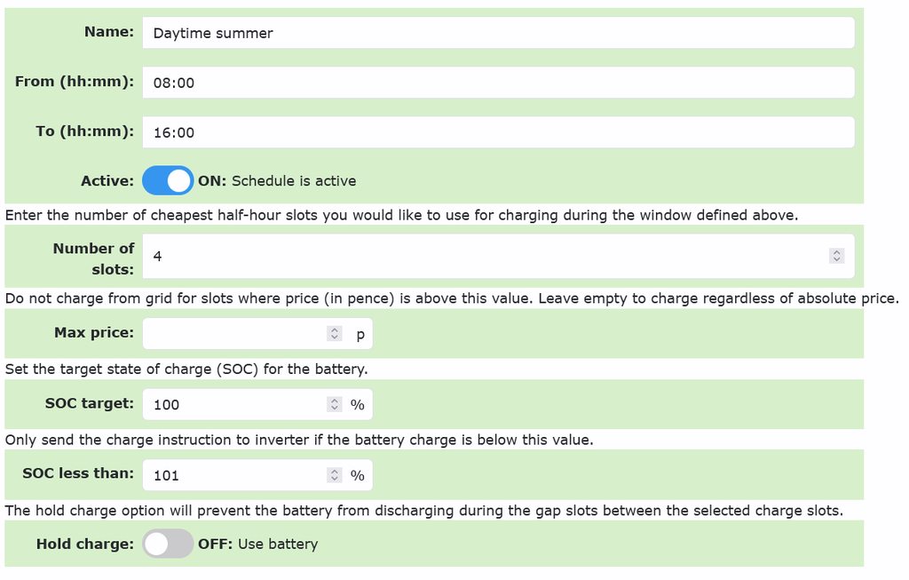

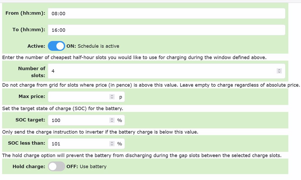

Finally got to test this today (Test SOC%=101 to force AC charge when battery full).
It doesn't seem to work.

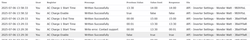

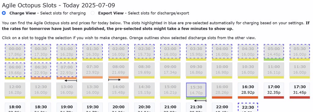

I have an agile window with SOC% test=101 and charge slots selected (13:30 to 15:00)

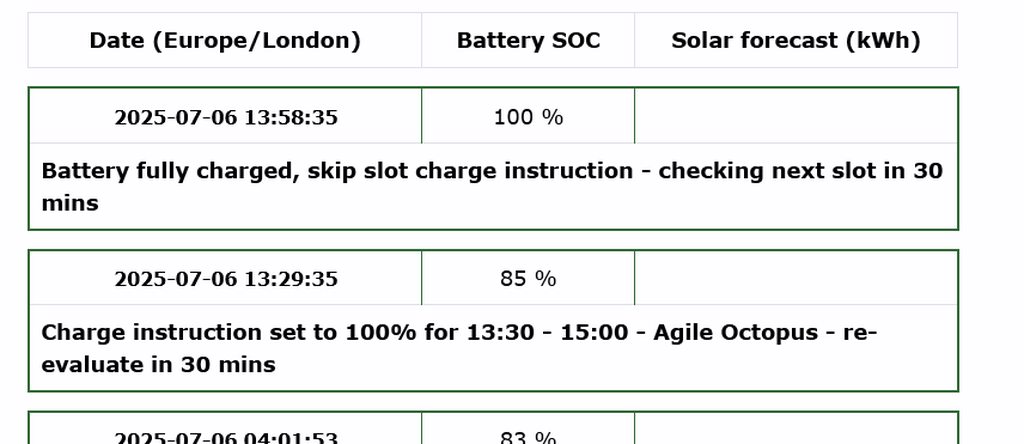

The AC charge started ok at 13:30 with a re-evaluation in 30 minutes.
At 14:00 the battery SOC was 100% but instead of keeping the charge going, WW did a slot skip.
And WW sent commands to stop charging
So it looks like there is a "skip if battery SOC = 100%" test before the "battery SOC less than the agile window value" test. :(
