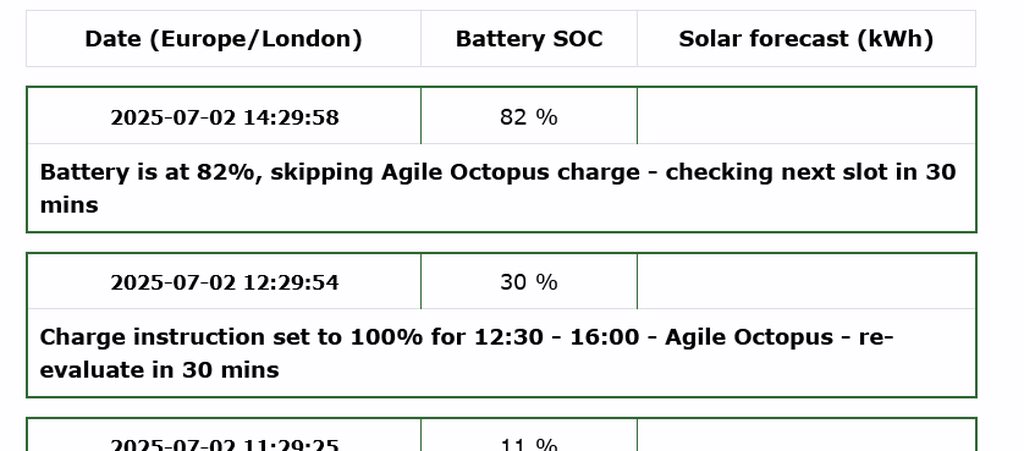

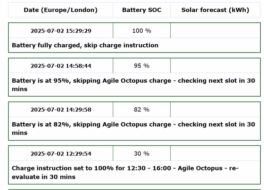

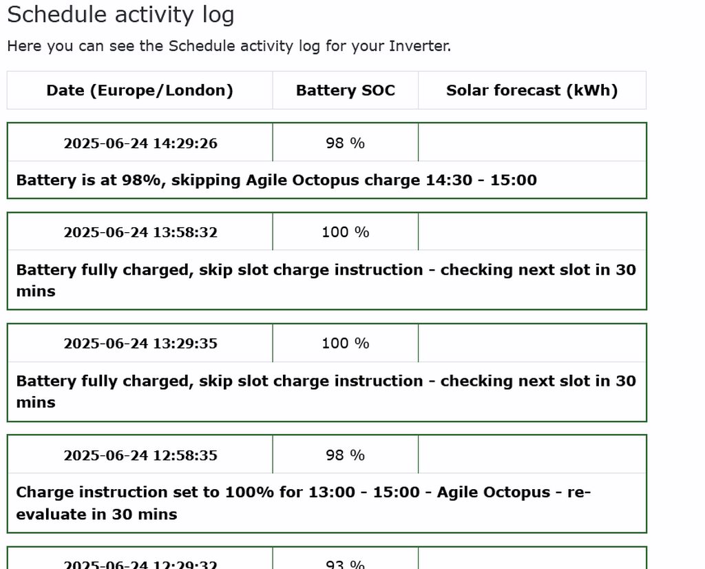

admin But this falls within your 13:30-16:00 Agile charge window, for which the SocLess Than is set to 60% hence those slots were skipped, as per design?
I guessed that was what happened. Just wasn't expecting it.
Will the slot keep charging if the target SOC hasn't been reached or is it just the start SOC that is retested?
Going forward, this re-evaluation is what I expected Agile slots to do in the first place so I like it.
Yes I have seen the other discussion but the revaluation change there just mentioned the price <0.00p and I didn't spot that it also included everything else.
