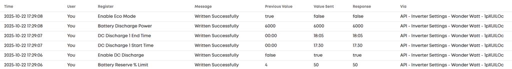

Now comes my issue, that I am seeing. I have altered the Correction factors >> Charge rate to be > 1.00 using steps of 0.1 [10%] as described in the guidance. I am up to 1.8 [80%] and yet again tonight, I see a Charge Rate of at least 5% lower than it needs to be to fully charge my AIO in the time window of my IOG overnight 23:30 - 05:30.
I completely drained the battery before the window to prove this absolutely this time. [Reserve of 4% withstanding].
As per my WW LOG, the current charge rate was set to 40%
Yet, just some simple math 13.5kW / 6 hours = 2.25kW
and 5kw * 40% [my WW set values] means I would miss my charge to 100% by at least 10% - even with a Correction Factor >> Charge Rate of 1.8
