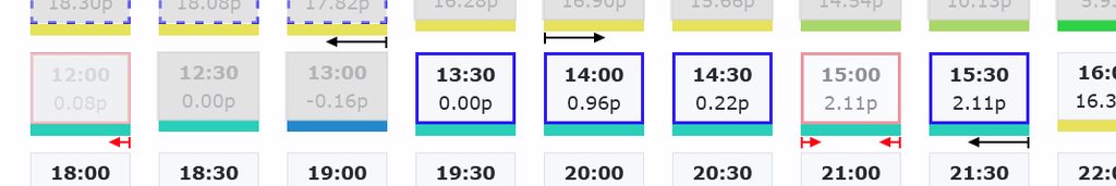

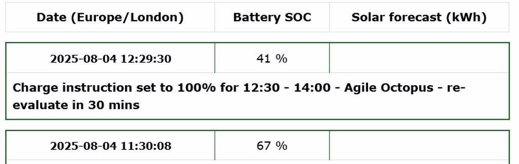

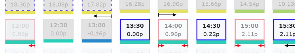

I have set up a test case. A charge block is in progress. 12:30-14:00
Then there is an export slot at 14:00-14:30
I change the export slot to a charge slot.
it is 13:08 so the 30 min re-evaluation at 13:30 should pick the change up.

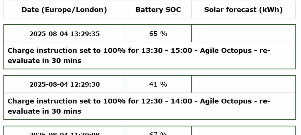

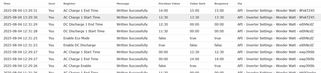

It is now 13:32 looking to see what happened at 13:30
Looks like the re-evaluation worked 🙂
Inverter will now charge until 15:00
