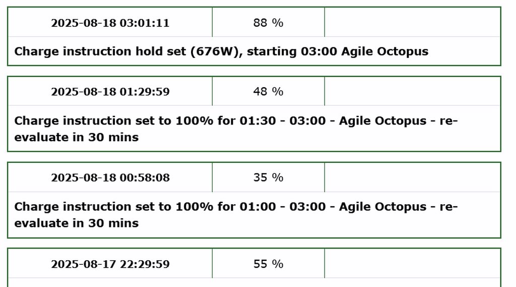

Last night I had a block of charge slots selected from 1am to 3am.

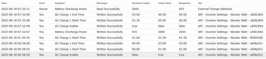

WW fired off the AC charge from 01:00 to 03:00 no problem.
30 mins later at the re-evaluation it decided to change the charge period to 01:30 to 03:00.
Nothing had changed on the Agile scheduler so the evaluation should have left things alone.
Later re-evaluations behaved as expected with no changes made.

Also, the HOLD didn't get cleared properly at 7:30am - Just noticed it was still set due to an External change detected event.
