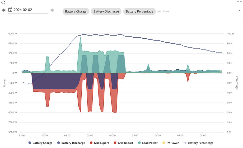

Firstly, thanks for fixing the 100% charge rate issue; I tried it out last night.

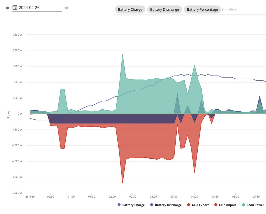

In the period following the charge, my immersion heater started up and was drawing from the battery at full rate for 10 mins, then the grid topped the battery back up at full rate for 10 mins. This repeated over the remaining off peak period.

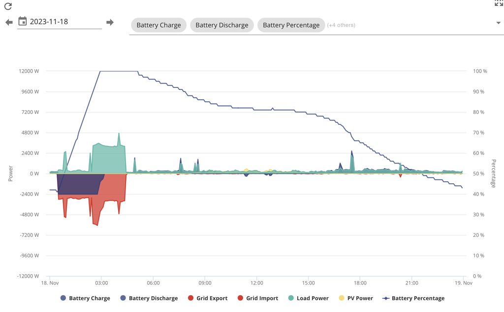

This is a new issue. It used to work correctly, example from back in November:

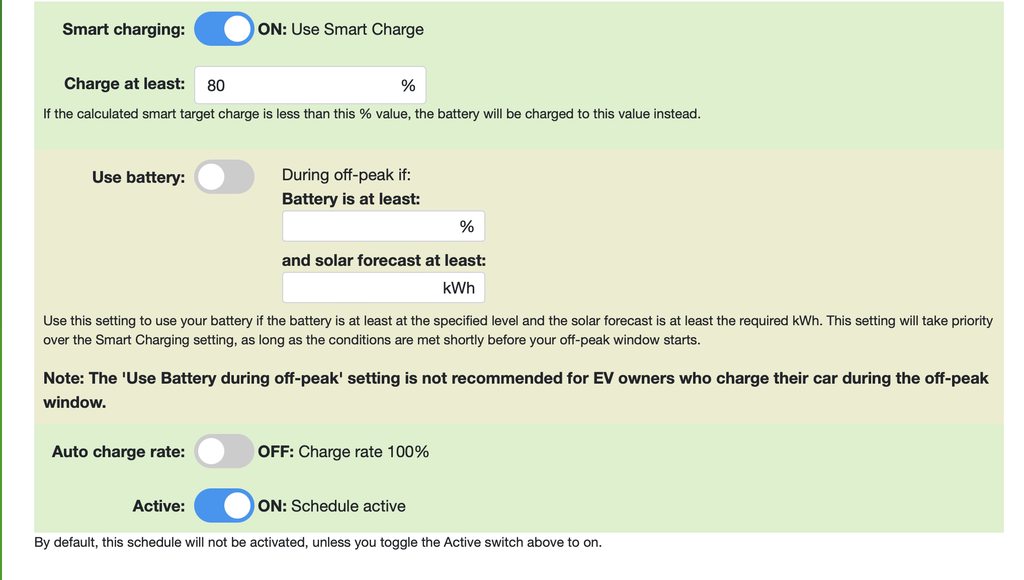

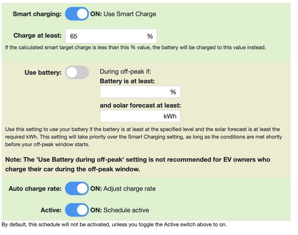

Here are the WW settings

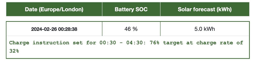

And here are the logs from last night
Grateful if you could take a look at this. 🙇

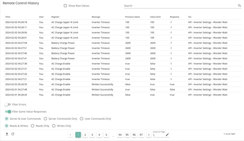

    Avenir Right, so this looks like an issue with the Giv backend as indicated by the response, where the inverter had timed out on all the settings, including the retries.
      admin Ah yes. So I guess the workaround is cross fingers and hope it doesn't happen again!
        Avenir Yeah - bit annoying really. Would be interesting to see whether this was the same issue with others too.
        We will increase the back-off factor for the retries. I guess that's all we can do at our end.

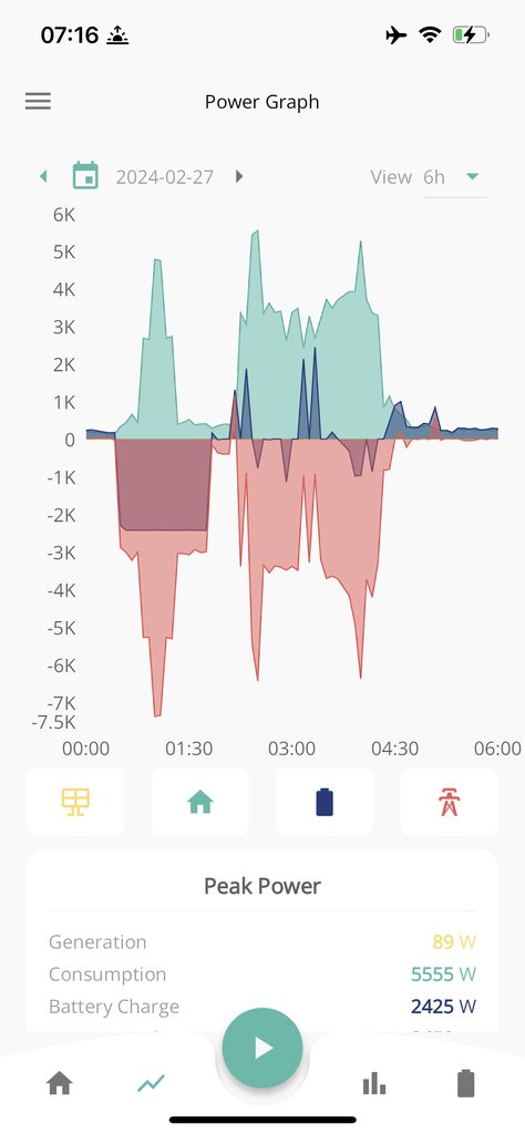

        Hi @admin I am still seeing the battery bouncing between charge and discharge in the 'off-peak' period, even though WW is set not use the battery off-peak. It's not quite as extreme as the example in my post above, but still present. As previously noted, this wasn't an issue back in November. I can't see any obvious timeouts or errors in the logs.
          Avenir Doesn't look like there's anything we'r edoing wrong on that occasion. It may simply be a side-effect of the charge rate adjustment and the way this works on Giv systems tbh.
          Back in November, we didn't have charge rate adjustment in place I don't think.
          Would be worth toggling 'Adjust charge rate' to Off and you probably won't see these wobbles.

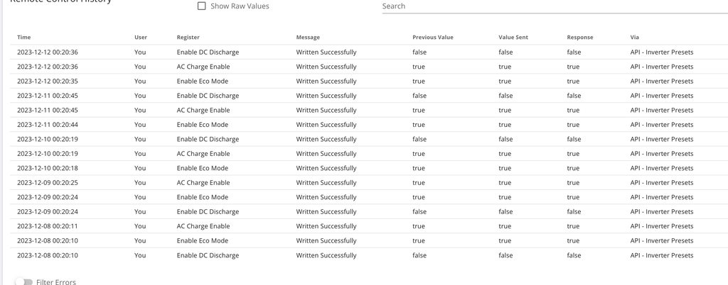

            Looking back in the logs, back in November/December WW would send a command to 'Enable Eco Mode', which is no longer sent. Could it be that this command prevented the issue I am seeing?
              Avenir
              We don't touch Eco-mode for charge schedules, so your default should be to have Eco-mode on, have you not got Eco-mode enabled currently?
              We only set Eco mode back to true after a Timed Discharge.
                admin Hi, thanks for the response. Eco mode is currently on.

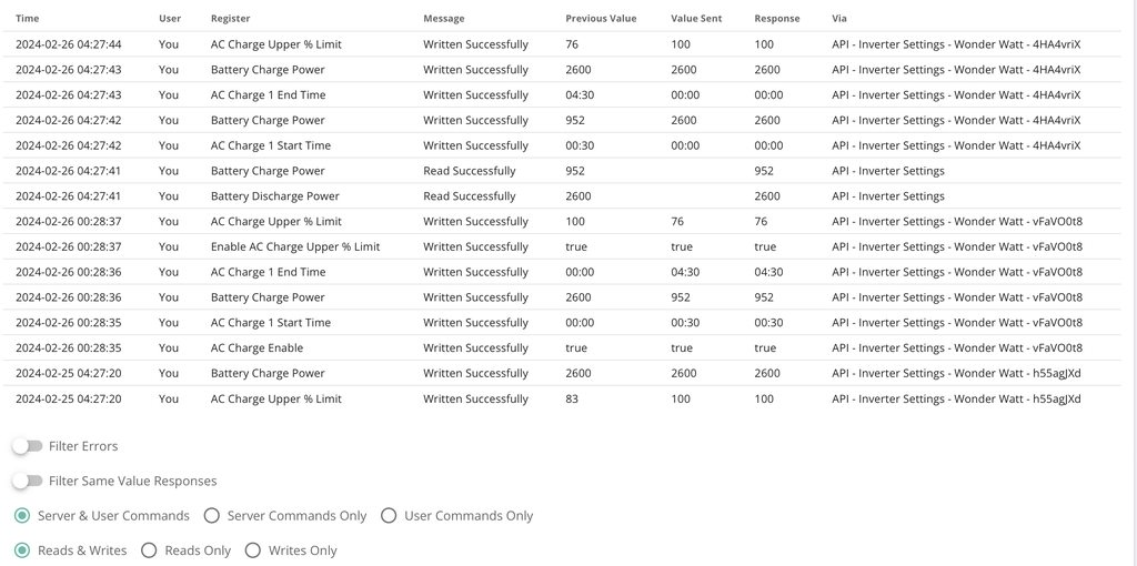

                The charging logs up to mid December look like this, with the Enable Eco mode command, which I assume is being sent by WW.
                  Avenir Thanks for digging that out.
                  So back then we were using the presets, but they were causing too many Inverter Timeouts.
                  I don't think it's related to Eco-mode. It's more likely the Enable DC Discharge being set to False.
                  We may need to do this during charge windows, and possibly during on hold.
