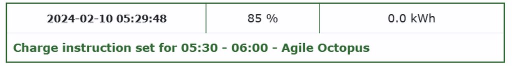

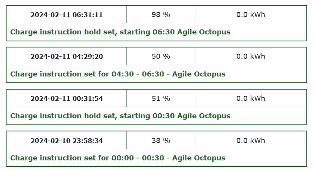

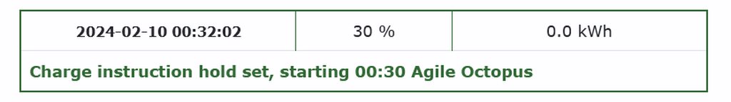

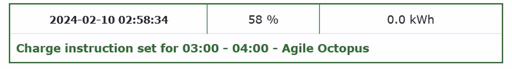

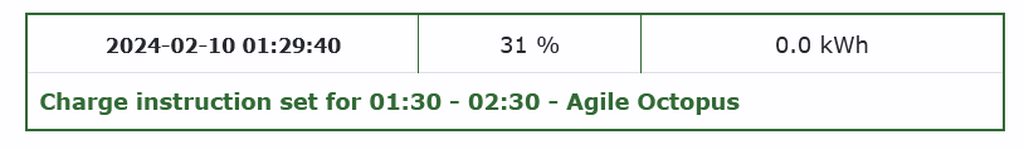

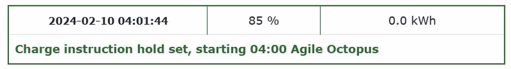

      Last night breakdown...

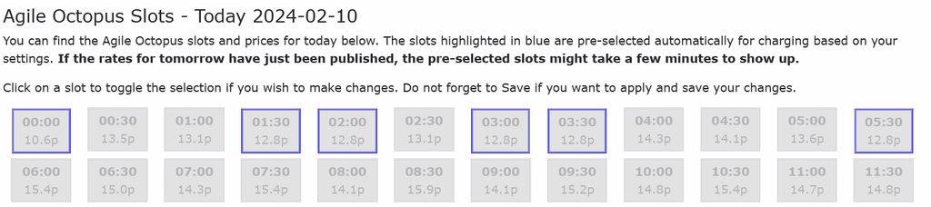

      Agile Charge Window is from 00:00 to 06:30
      Selected slots are:-

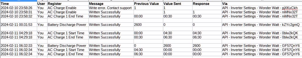

      First slot at 00:00 all OK.

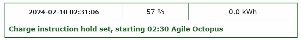

      First hold at 00:30 both charge and discharge set to zero
      Next charge at 01:30 Charge is restored to 2600 but discharge remains at zero.
      Next hold at 02:30 - Nothing received by inverter
      Next charge at 03:00 no change to charge or discharge values
      Next hold at 04:00 charge set to zero
      Next charge at 05:30 charge resotored to 2600
      Next hold at 06:00 charge set to zero
      Window ends 06:30 - nothing in WW activity log but inverter has this
      Battery charge and discharge both restored.
        johalareewi Thanks for the detailed breakdown, you can see the values that were sent but weren’t changed, by toggling one of the sliders at the bottom of the Giv log.
        All in all, went OK then? Note that the latest release does not reduce charge power in a charge hold slot anymore.

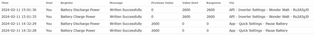

          Just had an interesting situation.

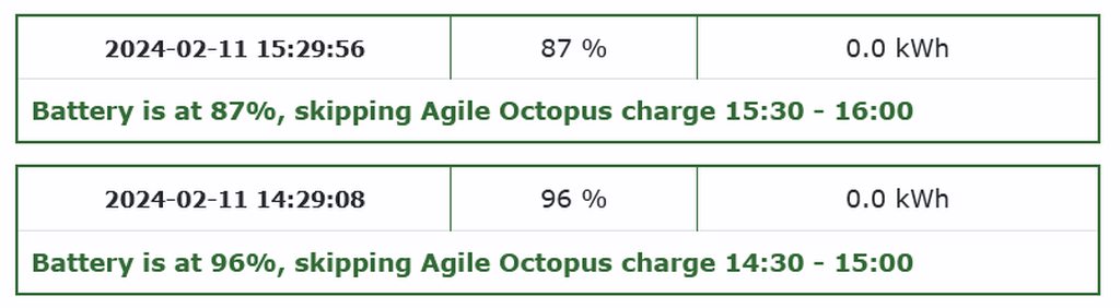

          Battery was at 96% and there were a few cheap slots coming up just before the peak period.
          Tumble drier was on so using the GE app, I paused the battery so the tunble dryer would use the cheap electricity and save the battery for the peak slot. This was OK but half an hour later, Wonderwatt issued a PLAY command sequence. There is nothing in the WW activity log (apart from the skipping charge) and the GE app said battery was still paused even though it wasn't.
          GE log
            johalareewi So that command was issued as part of the 'disable charge slot', which had just passed.
            Part of disabling a charge slot (whether a charge happened or not) is to reinstate discharge power (and charge power - gets reset too if it's less than max)
            Not sure how we could decide not to, and know about other external ways that users might well interact with their Giv systems that we can't possibly all cater for?
            The GE app is quite prone to still having stale or cached values.
              admin So that command was issued as part of the 'disable charge slot', which had just passed.
              Ah. Didn't realide that still happened when a charge slot was skipped due to high SOC value.
              Still learning how this works.
                johalareewi It’s all good. I guess we saw it as something that wouldn’t cause any issues at that point. Most logical is to set those values back, as only occasionally you might mean them to be at 0.

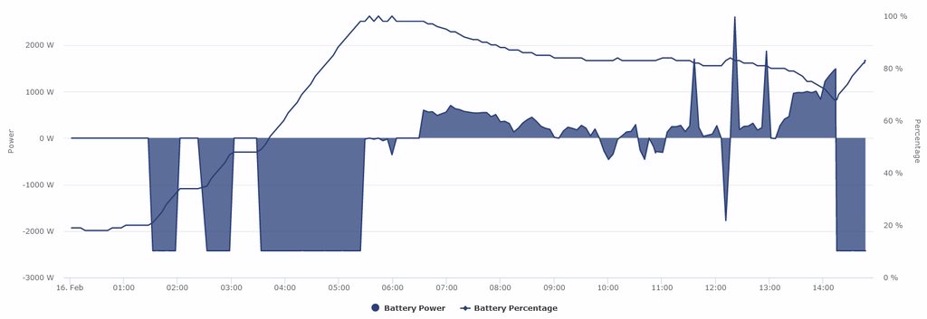

                Hi, relatively new to this and seems a great product. One thing is during the 'gap' periods on agile my battery seems to be half on hold, half not, in that according to the giv portal it's trickling out c.300w with the rest of the load being met by the grid, rather than holding on whatever SOC it's got to in the previous charging window. Could you look into it? I'm tremendous-control. TVM
                  I think some Giv inverters will allow small battery discharge even when Battery Discharge Power = 0. I have a Gen 1 HY3.6 inverter and it doesn't discharge at all but on the Giv community, others have said thier inverter allows around 300W to discharge. Would be interesting to see which inverters people have who are using the Agile Hold feature, and what happens.

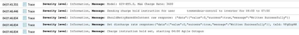

                  freakouthtesquares Looks like we do just send the 0 discharge power and the Giv response acknowledges that it has been set, see below - but your Giv HY5.0 inverter still discharges somewhat.
                  As @johalareewi says, and I read similar things in Giv forums, some inverters are still discharging somewhat, despite discharge power being set to 0.
                  Our alternative approach to set SOC target to current SOC had a similar effect, which is why we switched away from that.
                  All in all, it's something that's unfortunately out of our control.
                  Thanks both. Bit odd as it would maintain a steady SOC under the schedules I had set up via the portal, i.e. if charging window was 2-7am and it got to 100% SOC by 5am, it would remain there until 7am.
                  Also FWIW my inverter is definitely HY3.6 but for some reason in the portal it is marked as HY5.0
                  Gen 1 HY3.6 seem to come in different flavours depending on age. Also, there are reports on the Giv community that some HY3.6 are downrated HY5.0.
                  My Gen 1 was very unhappy with the SOC method to prevent discharge, even though with SOC = 100% it behaves as you describe. It could also depend on battery firmware. SOC calcs are a bit hit and miss on my battery. :(

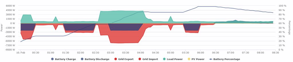

                      Example of my battery SOC wobble. Around 6am, Agile HOLD in place so no battery discharge, but SOC flip-flops between 98% and 100%.
