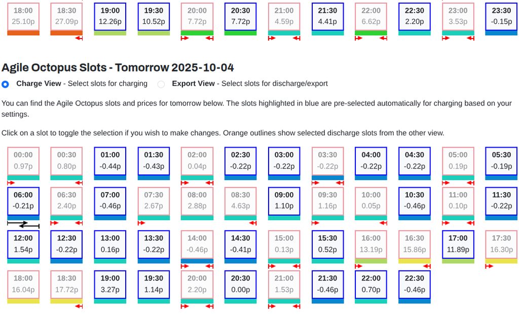

This schedule was produced by WonderWatt...

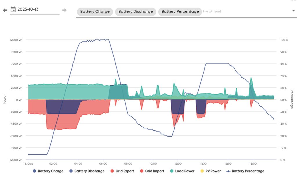

This is a picture of the settings (not exactly the same as I made some edits during the day after I took a screenshot of the schedule unfortunately)...
The Blue outline boxes charge at 100%, the Red outline boxes discharge at 100% which results in exporting what's left after meeting the house load.
At around 4.30pm each day (so not set and forget) I look at the next days slot pricing on WonderWatt and, if it's a plunge day with many slots below 13p, I select charge and discharge slots to maximise my exports whilst minimising the import slot costs. I receive 16.5p per kWh from Eon Next for export so, factoring in around 20% losses through the battery, slots below 13p are worth importing then exporting.
My system is GE AC3.0 inverter, 2x 5.2kWh batteries (+ 6kW Solaredge inverter and 17 panels) installed in May 2023.
Notice the massive house load between 12.30 and 2pm. This was the free Octopus session where I managed to import 14kWh by turning on the aircons to heat, heat the water, clean the oven, run the dishwasher and washing machine and charge the batteries.
Overall I made £4.30 on exports that day at a cost in imports of 30p - net £4 not counting what I might get from the free session.

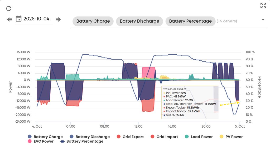

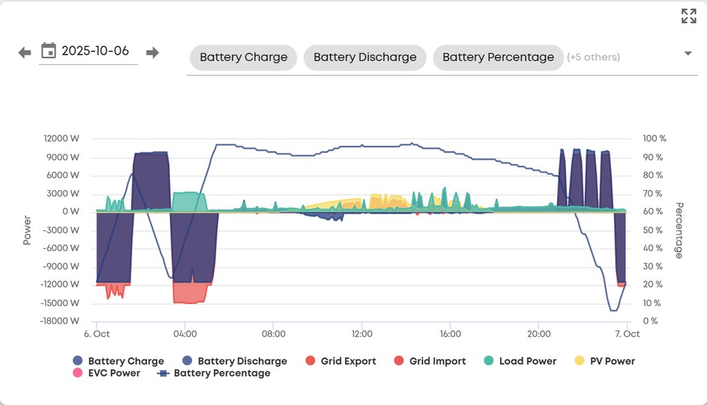

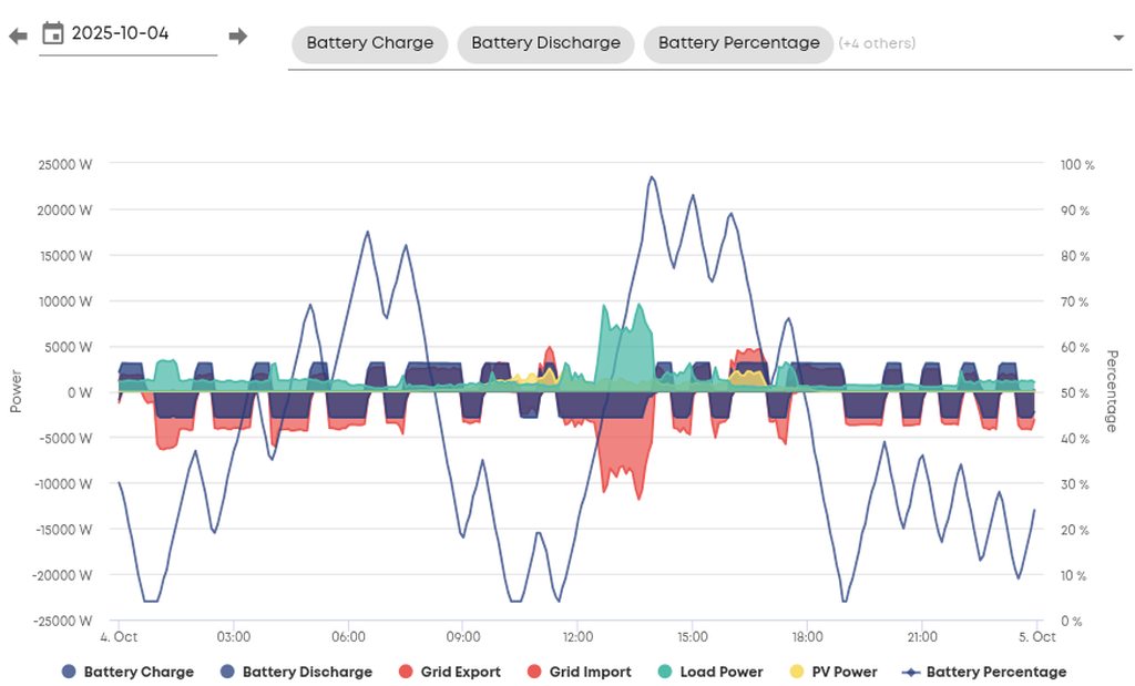

Note however with Agile that you only get 2 or 3 days a month like this when the wind blows strong. The rest of the time Agile hovers around 16p as its minimum price. During the summer with Solar I can charge in the day and last the night. But from now to February I have to use imports so I seek out the cheapest 6 or 7 slots each night to charge the batteries and a few more in the day if necessary. All under WonderWatt control.

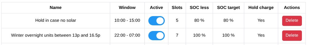

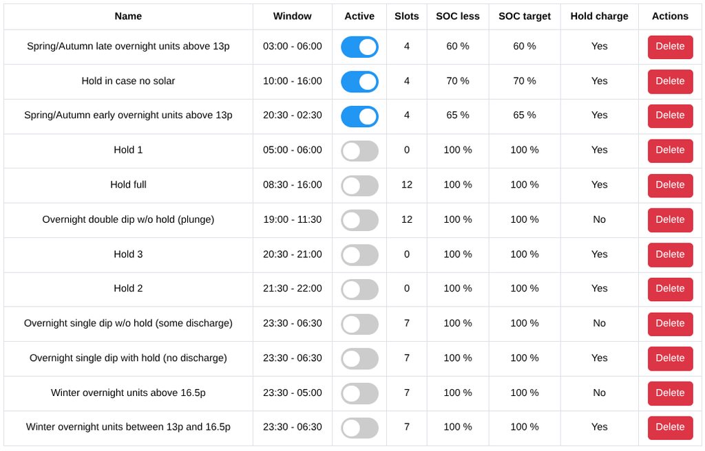

These are my pre-defined charge schedules I switch on and off and make minor adjustments...

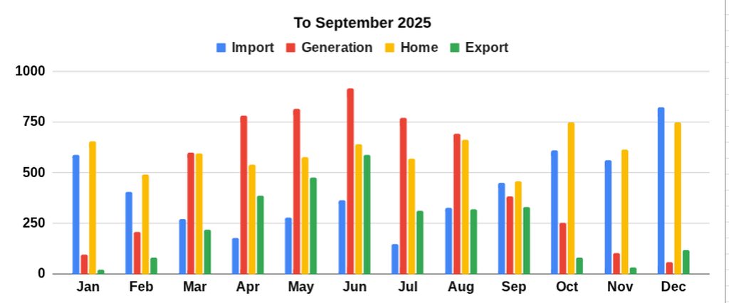

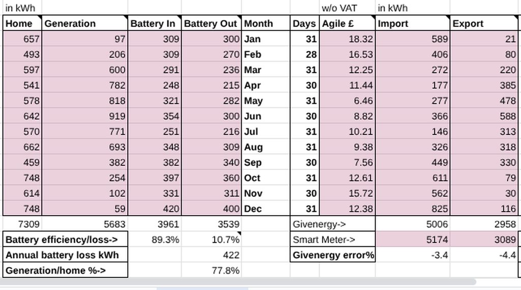

Here's my yearly pattern of usage...

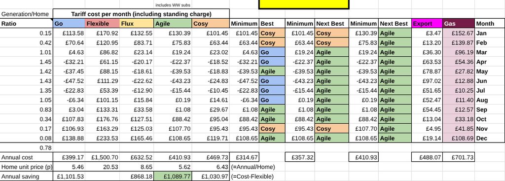

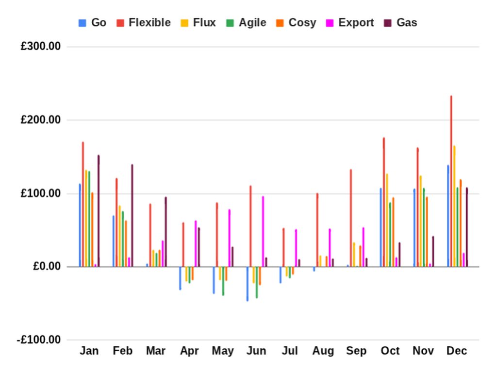

And here's my tariff compare table adjusted for my usage pattern and battery size (which is too small to last 18 hours between charges)...
I don't have an EV so can't get GO and I don't have a Heat Pump so can't get Cosy. Flux is never the best tariff. Hence I'll stick with Agile for the time being.
This shows the potential of WonderWatt controlling the battery inverter with the Agile tariff but it has taken the best part of a year to fine tune it (which of course is to be expected as things change with the seasons). I hope you can follow it all.
