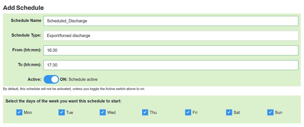

In terms of export, most users on agile have a fixed 15p/kWh export rate, and you can set up separate export schedules in the Schedules section.

Why did my charge slot or export slot not run?
The scheduler for those slots runs every 5 mins. This is to save unnecessary service calls and reduce database load. As such, if you set a slot less than 5 mins away, it could be that your slot is missed out. To rule this scenario out, if you set slots that need to be run asap, starting them 5-6 mins from now is recommended.

When running an Export/Forced Discharge, I see an endtime with (adjusted) after it. What does that mean?
Based on target stop SOC, current SOC and max discharge, we set the export end time to be the expected/adjusted end and revert back to Eco-mode. More details here: https://community.wonderwatt.com/d/189-release-441-scheduled-export-fix
