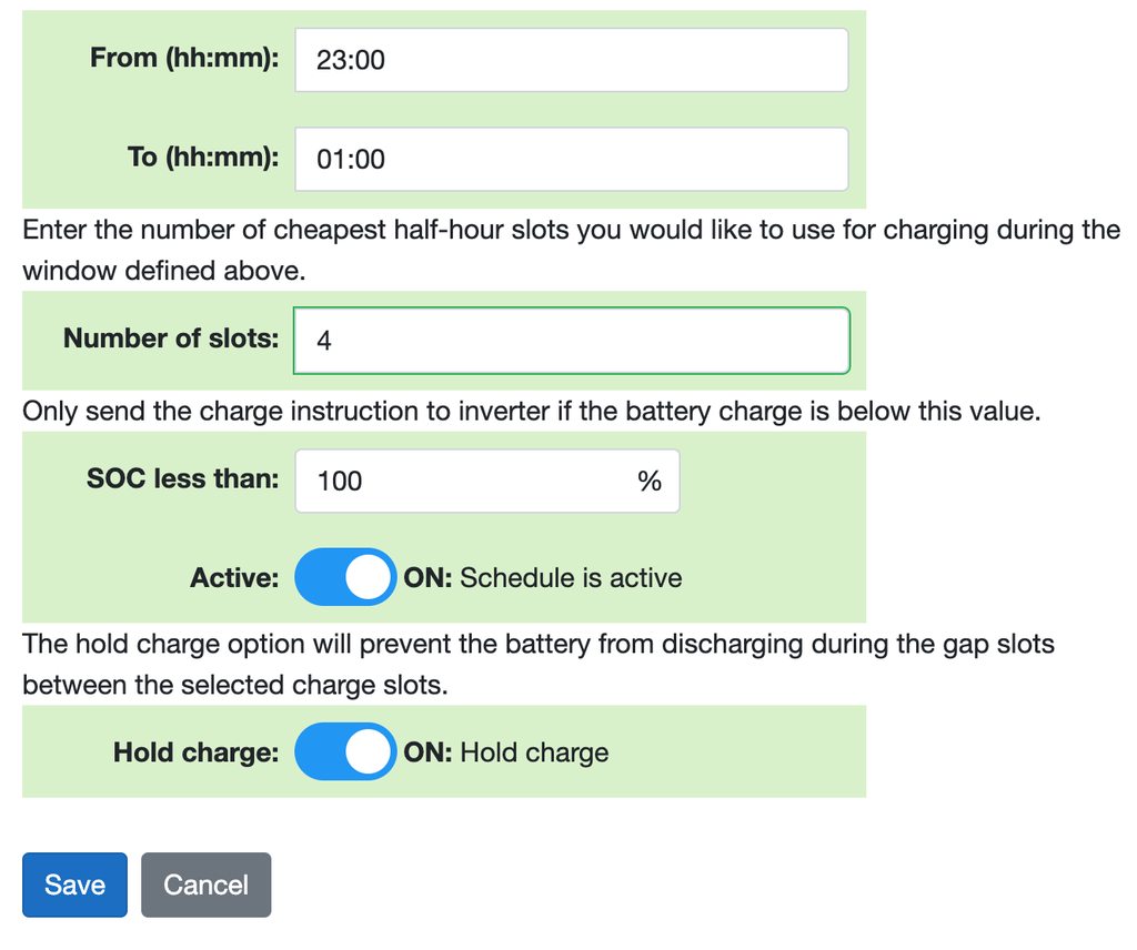

As you can select individual half hrs to use for charging, will there be a way to select individual half hrs to not discharge? Or set a price for when the grid as apposed to the battery should be used to power the house? Also, if a half hour slot is selected, say at 1am and the next is at say 10.30pm the same day, wouldn't the battery hold from 1.30am untill 11pm?
    Mat
    Not currently, we're trying to achieve that with this Hold Charge functionality.
    No, the battery hold only is in place for any non-charge slots within your Agile Charge window. In other words, if you have an Agile Charge window from 00:00-06:00 (with Hold charge ON) and only one cheap slot at say 1:00-1:30 is selected, the hold charge starts at 00:00-01:00, then your charge happens, and the hold charge will continue from 1:30 until the end of your configured charge window, which is 6:00AM.
    Makes sense?

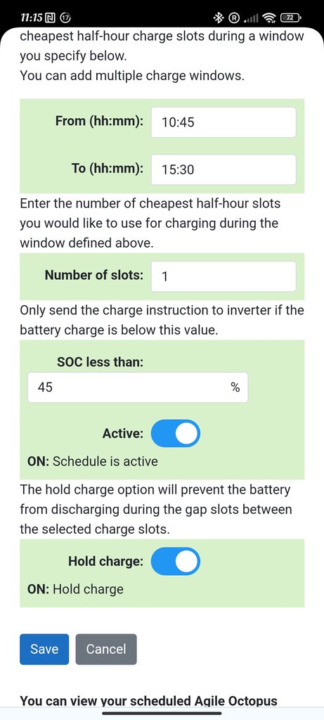

      Inferior-opposite here! Just playing with the hold feature and I thought I would be seeing the battery hold until the 1130 slot I set and then go back on hold after that slot. The slot was set that was the cheapest so I know the command went through. 🤔
        Mat Thanks for that, might be an edge case we've overlooked, where we need to issue a hold charge straight at the beginning of the charge window.
        Will look into it!
        • Mat replied to this.
          admin cheers. To confirm the charge slot started when it should at 1130. I didn't know if it had anything to do with setting the session up so close to when I wanted it to start.
          admin sorry me again, id set the charge to 45% but it's carried on past that. The GivEnergy app shows that the slot has been inputed but that the 'charge upto' is still on 100%
            Mat The SOC you set there is basically a minimum threshold setting (SOC less than) - a condition that needs to be met for the charge slot to start, not a "charge up to".
              admin got ya. Every day's a school day. On a hold, does that also stop the solar going into the battery and into the house if its sunlight hours?
                Mat
                Yeah, solar will basically go to the house in this mode (or flow grid side if there is excess) and won't go into battery.
