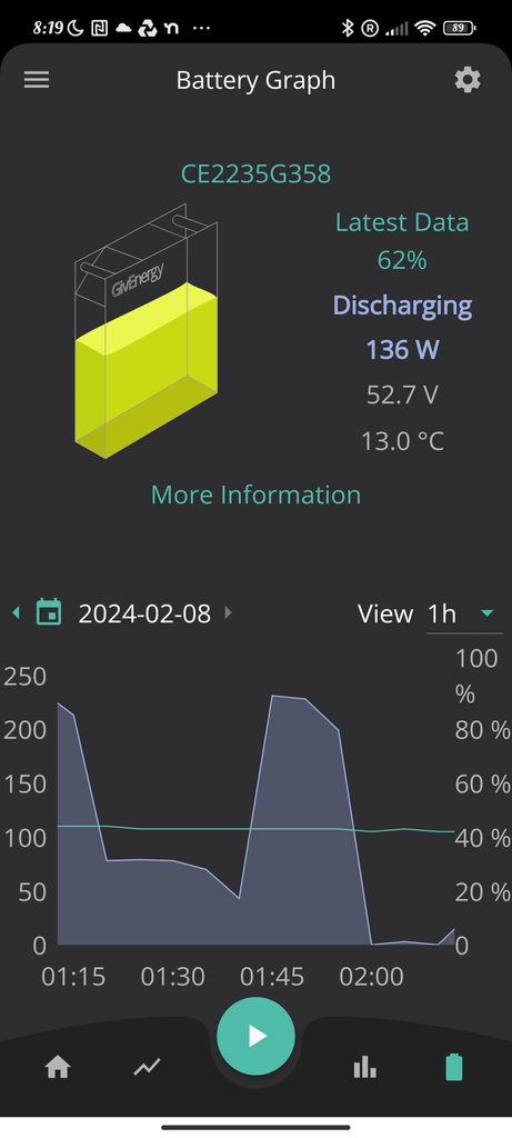

        I used the hold feature last night between 3 charge slots. The log on ww shows the hold command but the house was still drawing from the battery apart from during a few random minutes.
          Just signed up to WW and tried out the hold feature last night. Didn't seem to work.
          Will post screenshots later but have to pop out right now.

              Mat It looks like it's working, this may have to do with the way we implemented 'hold charge'.
              We're simply setting the charge target percentage to current SOC. And it does look that there are still some fluctuations going on, but on the whole, it looks like the battery stays at or around the SOC.
              This mechanism works quite well on Growatt, but for Giv, it may be better to effectively reduce the discharge power to 0 during a hold-charge slot.

                admin so what you're saying is that because my nighttime usage is low, the battery is still trickling? Max load is around 200w ish. There's always something on though as I have a ventilation system running although there's less than 40w from what I remember. The test would be to do washing or something during the night and see what the battery does?
                  Mat The test is, does your battery get to the end of the hold period on the state of SOC as it was? Not whether it may well charge and discharge little bits.
                  But maybe we should explore 'pausing' the battery and reducing discharge rate to 0 if we can.
                    That does explain the strange fluctuations during the longer hold periods.
                    Battery would kick in and out at 'random' intervals.

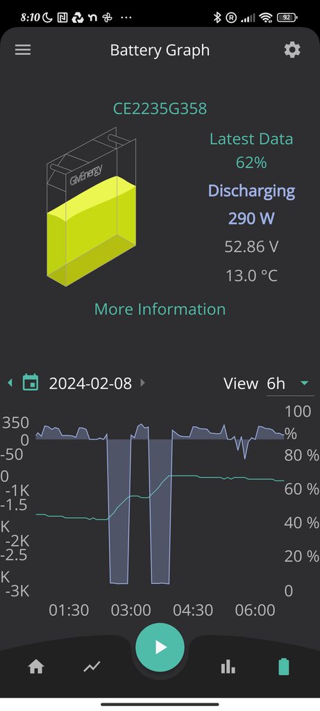

                          admin Can you Pause and then Play again a minute later and send us the Giv logs please when you have a moment?
                          Here goes. Battery was charging. I did a pasue on the app and battery stopped charging (and discharging). Then did Play to resume everything. Is this what you want from the inverter log?
