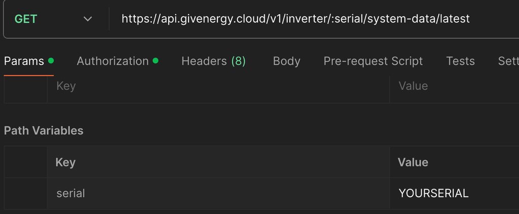

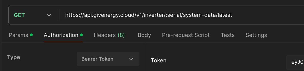

With Postman, create a New Request and put this in:
Add your API key the Bearer Token section.
And put your inverter serial in the params section:
Then click Send.
You should see a JSON document response and a Status code of 200.
Instead, you will see a standard Server Error HTML response come back with no useful information.
