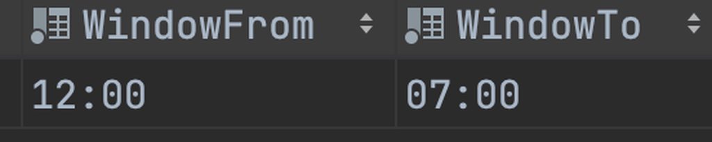

I noticed you have your Agile charge window set from 12:00 - 07:00?
That is probably the root cause, use 00:00 for midnight, otherwise it's effectively using 12:00 noon to 07:00 in the morning? Unless that is what you are after?
Did you change this recently?
