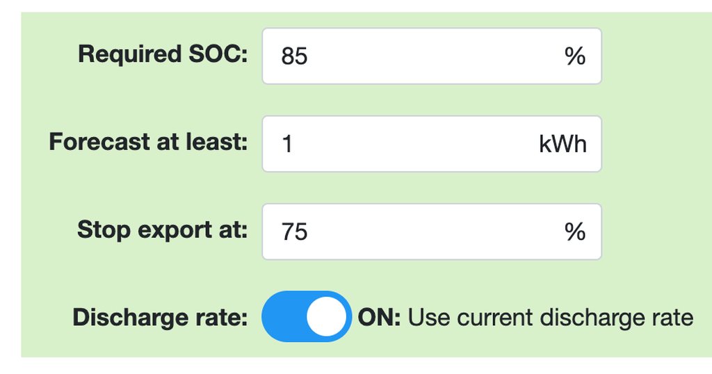

                          @Ifgow This has now been rolled out and is available in Release 640.
                          By default, for Giv users the export schedules will calculate the adjusted end time based on the currently configured discharge schedule.
                          If toggled off, 100% discharge rate will be used.
