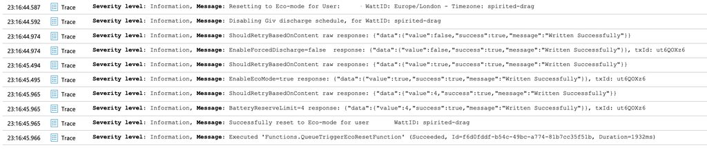

OK - so looking at our diagnostics logs, we did send a successful Eco reset at 23:16 - see:
You should also see this in your Giv log.
