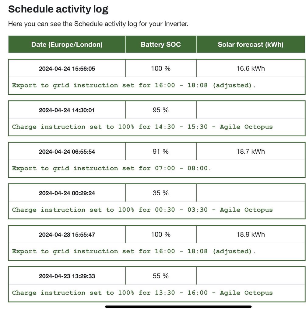

I have a quick question as it may affect the discharge to grid algorithm? & affect the end time calculation.

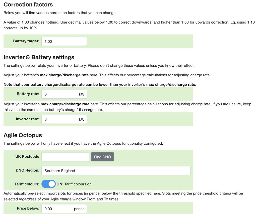

I have a SolarEdge inverter at 6kW, a GE AIO that can charge and discharge at 6kW, however I have a DNO restriction of 3.6kW discharge.
I have put these settings in the Advanced Tab/Inverter & Battery Settings. But there is not a setting for DNO export limit?
