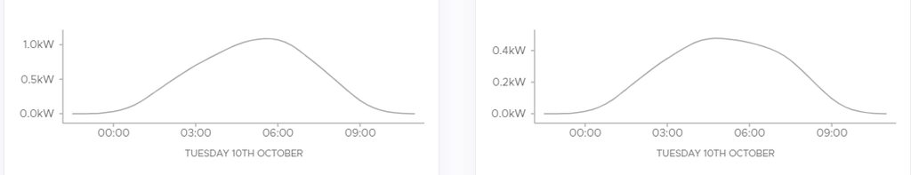

Example of the two graphs from Solcast (one graph per roof):
As indicated elsewhere on this forum you can indeed come up for now with a guestimate of the equivalent for both roofs as if it were to have one orientation and pitch, but there's a big difference between winter and summer with that approach and therefore quite inaccurate.
