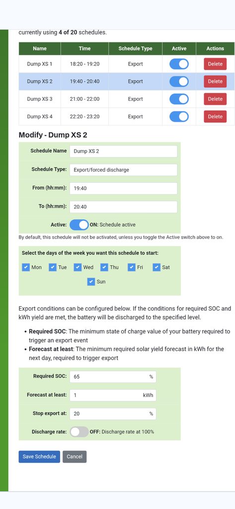

              To achieve this, I've set up multiple, sequential discharge schedules...
              I'm sure you can figure out what the other two are.
              The thing here is, they only run if there's sufficient capacity available, so I'll never get caught short. Equally, I'm ensuring they run as much as possible.

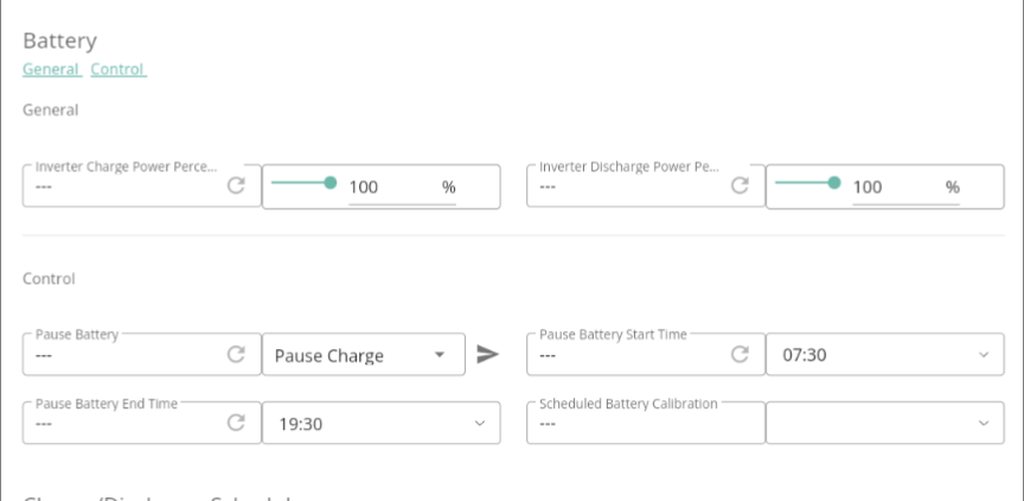

                  1. Tell me more about "I use the pause charge option in the Giv portal, so that no solar goes to the batteries" - I was under the impression we couldn't stop the solar going to the batteries. Can you share what the settings look like in the GivEnergy portal

                    1. If your inverter is a gen2 hybrid or newer, you should have this setting in the web portal, inverter, settings..
                      As I said, depending on how we go with the ASHP, I may change this when it gets properly cold.

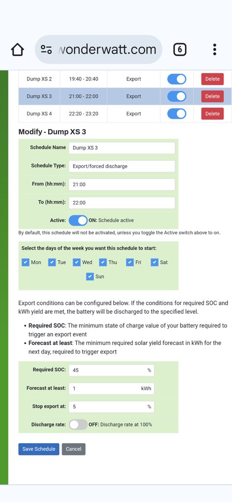

                    3.Sure, here's the other two..
                    In the "schedules", you can see I've got them all in sequence to make it easy to see what's going on and because they've all got calculated SoC queries, there's no need to change anything throughout the year.
                    I've worked out 1hr discharges 21% of the battery capacity, hence I have them set to 85, 65, 45 and 25%
                    You can see if I was at 85% when the first one started, the second one wouldn't run. Conversely, if I'm at 84%, the first won't run but all the others probably will.
                    If I'm at 25% just as the last one started, I'd hit 4% at the end before the charging starts again shortly after, so worst case 10mins of grid draw.

                        I've picked only "pause charge". You don't want "pause discharge" or "pause both" as that would stop the battery covering the house load. That's the sort of thing someone with a small battery on Agile might do to save the battery for the peak period.
                        Solar and battery will still cover (as much as it can) house load.
                        Whether you actually want to do this may depend on you normal daily consumption.
                        Without the heatpump, we're currently using maybe 6-8kWh. Even on a rubbish day that's pretty much covered by solar.
                        The times I've got set are a combination of maximising solar export, but also to suit our EV charging requirements.
                        If you regularly have smart charging slots during the day from Octopus and want your giv batteries to charge, you might not want to use this option.
                        As I said before, I may switch this off for winter as some bonus slots from Octopus may come in useful.
                        If we look at this partial trace from yesterday, which was particularly rubbish for solar, we can see the house load is entirely covered by solar and battery apart from a few spikes late on.
                        The lack of trace below the line is because precisely zero solar has gone to the battery, but equally virtually nothing has come from the grid either.
