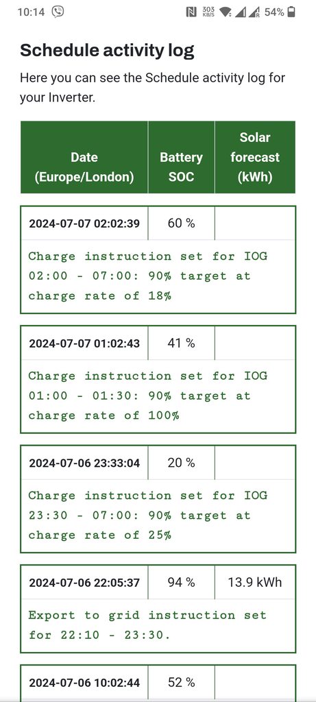

I tested and it works now. Even better - it seems improved. I got slots up to 7am and WW added 23.30 - 7 as my schedule so it includes the full night slot plus the extra. Thanks for the update.

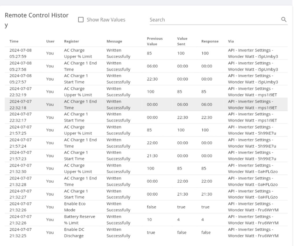

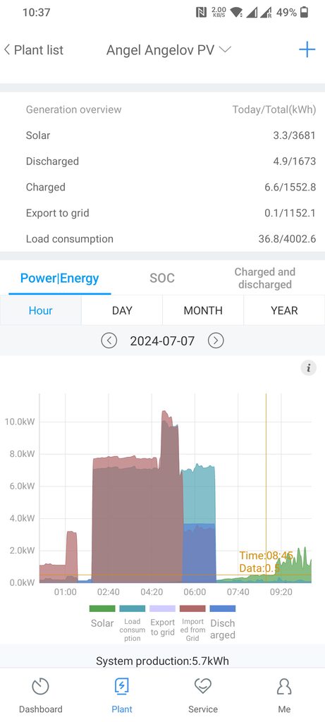

    angellevski Spoke a bit too early. My battery got drained after 5.30 but I can't understand why. Activity log seems to show all correct. Any ideas?

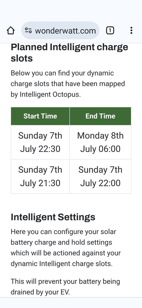

      Can anyone tell me how long after starting the charge and receiving the additional slots (via Ohme app for me) should I expect to see the planned IOG slots in the WW app?
      THanks
      Further to the above, the slots never appeared. Could support please advise what I am doing wrong?
      Slots never appeared so I put manual hold on battery.

      angellevski that’s a strange one, we’ll look into the instruction we sent. Bear with us until Mon/Tue pls.

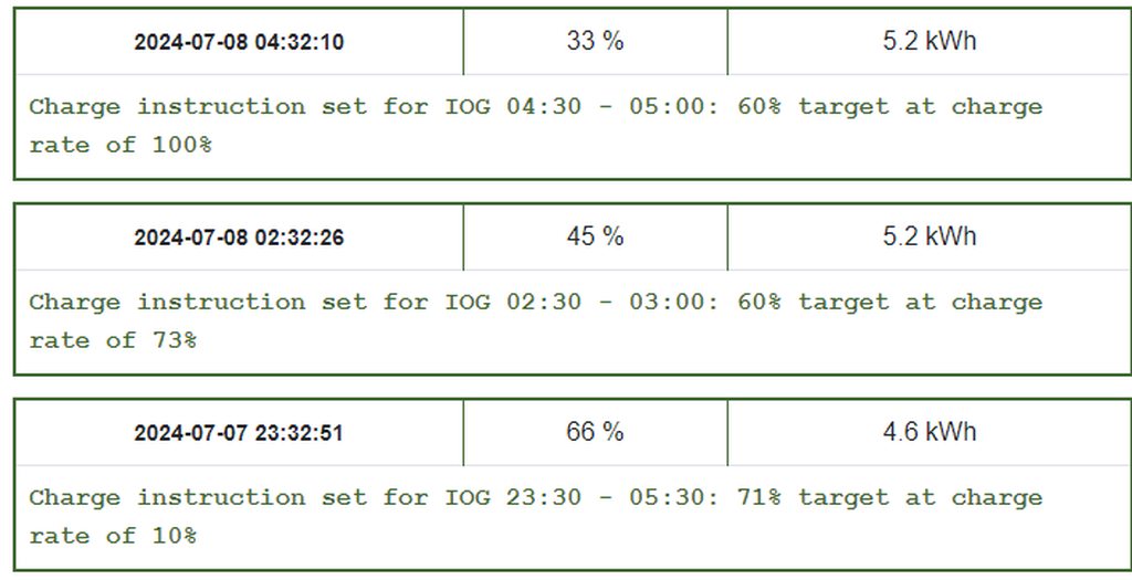

      Just to let you know we had something weird happen on morning of 8/7/2024. Battery charged then discharged (possibly into EV), then recharged, then discharged again, then recharged and started discharging again, all during the off peak window. Looks like there were extra charge slots added:

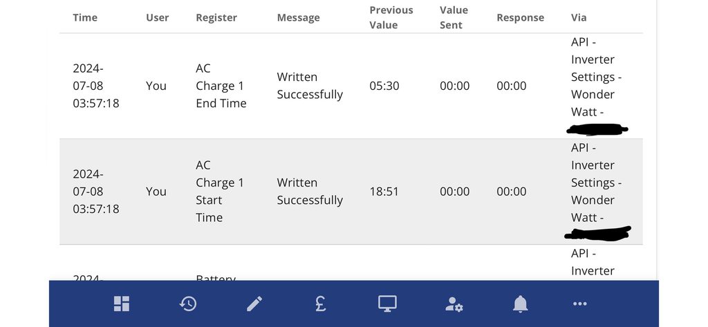

          PeteC Right yeah, it's weird really why Octopus maps a few slots that fall in the 23:30-05:30 IOG cheap rate window, but perhaps we should ignore mapped slots that fall completely within this IOG off peak window.
            extraneous-pattern Great, thanks for digging that out.
            So it looks like a mapped charge slot was issued for 18:51-04:00 by Octopus, and we picked up the 04:00 AM end charge.
            We need to add a fix where if the end time for a mapped charge is within the main IOG offpeak window, we extend it to 05:30 by default.

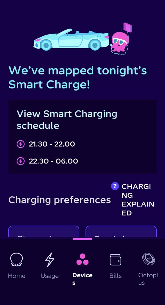

              Tried my first charge today and got slot from octopus but not showing on WW
              Anything obvious I'm doing wrong?

                  It did seem to pick it up from 23:30 but it mapped the charge from 20:30

                    Car isn't plugged in but still showing mapped slots. Is that normal?
