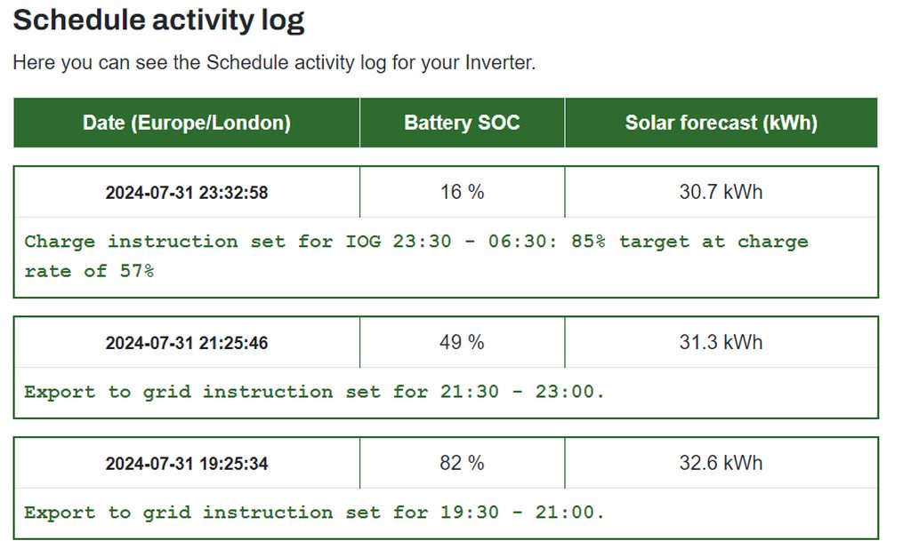

I had a smart charging session last night 23:30-05:30, 05:30-06:30 (nope, I don't know why they spilt it as there was definitely no break according to either the GE inverter or the Zappi).
This seemed to be picked up perfectly by WW, as seen here...

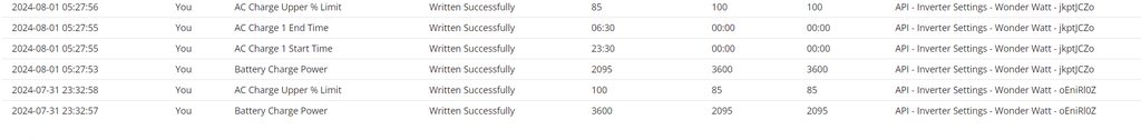

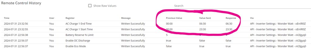

... and here .......
However, instructions were then sent at 05:30 to switch charging off .......

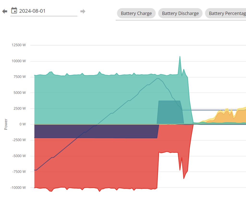

....... leaving the battery to drain in to the EV, which was still charging until 06:30 .....
..... until I spotted it when I got up.
