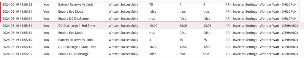

I have a WW rule that runs 12:00-14:00 that says if the SOC is above 90%, export down to 75%. It triggered today. However this is what my inverter log showed:
The commands in the red box above had no business running at that time! They should have run at 13:05! The WW rule triggered, and ran the correct commands using ref O59HmiQk. However, almost two minutes later, commands 0HlLCPuH turned them off again! So my export did not take place.
What the heck?
