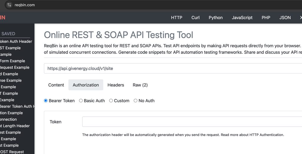

        You can test your API key out by using https://reqbin.com
        In the URL field, paste: https://api.givenergy.cloud/v1/site

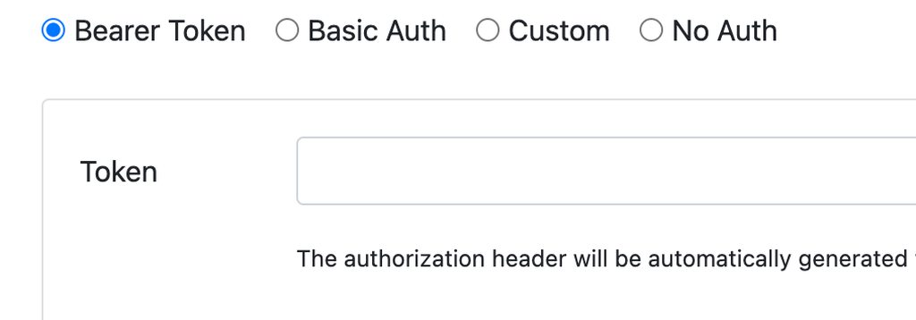

        Then click the Authorization tab and paste your API token in there:

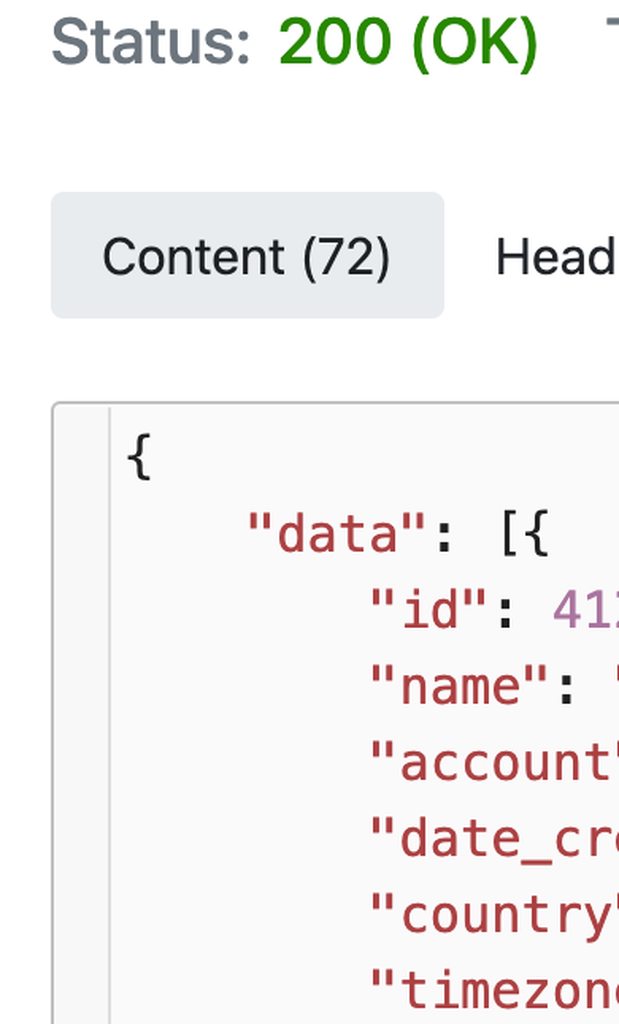

        Click Send, and you should see a valid JSON formatted response like this:

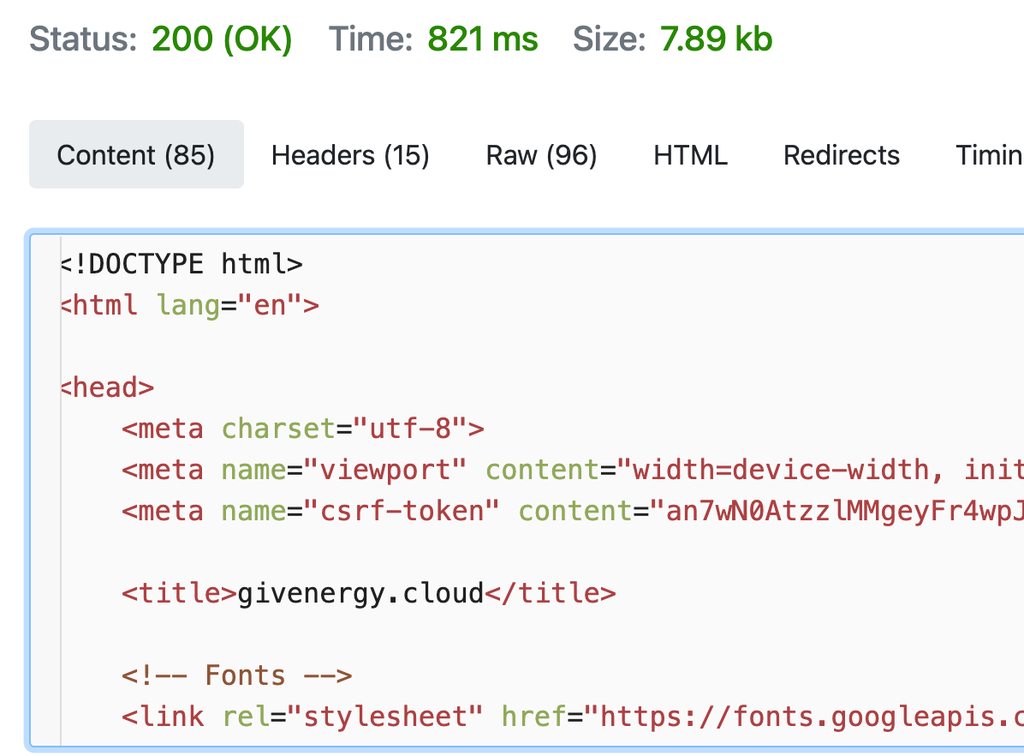

        NOT HTML like this:
        This is what comes up. Is this a JSON response. Apologies I am not an IT expert....

          Ijhhh Yeah, likely something up with the API key permissions. You are getting the HTML error response page.
          Giv should actually make sure this is a genuine JSON response with error details, but we’ll try and pick that up with them.
