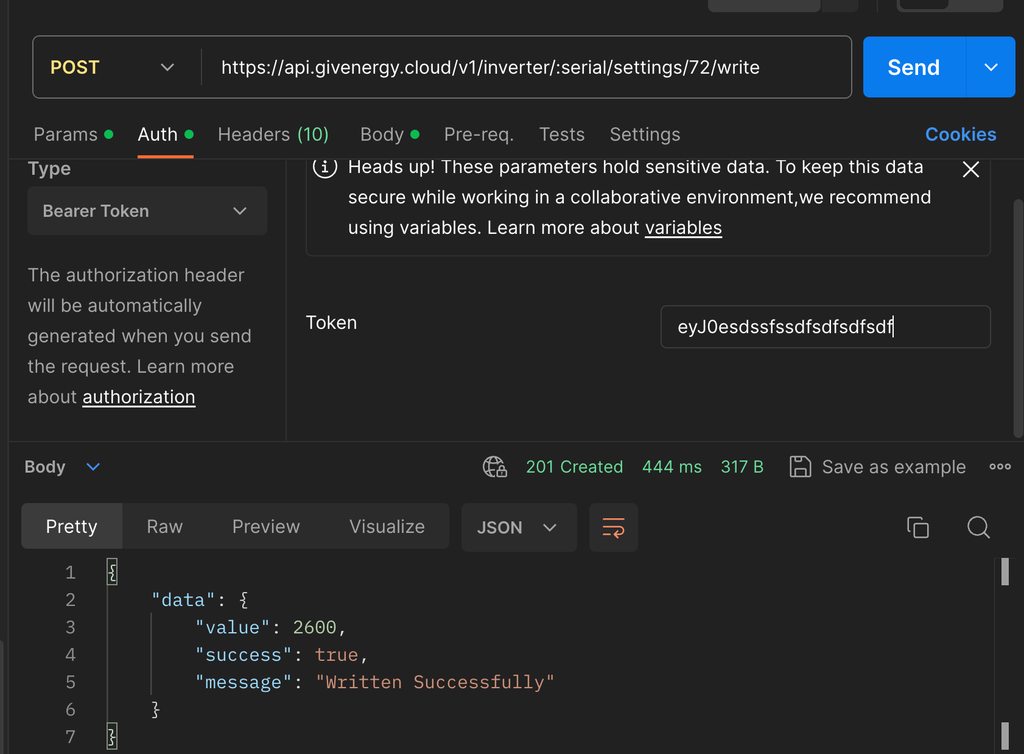

To eliminate the issue, you could test this out with your own API key in a tool like Postman.
Put your API key in the Authorization tab, select Bearer Token and paste into the Token input box.
And make sure you replace :serial with your serial number.

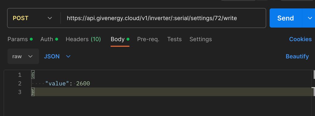

Put your max charge power into the body, like so:
And click Send. I'd imagine you would get a similar error message.
Happy to try this on your behalf if you DM us your API key. Cheers!
