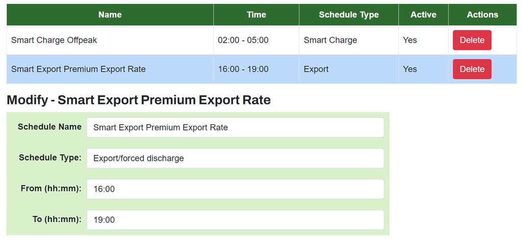

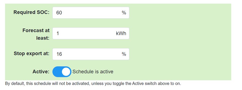

I'm trying this out by now also adding an export schedule, but I can't get it to work and after having checked all settings, can't figure out why it would not work.

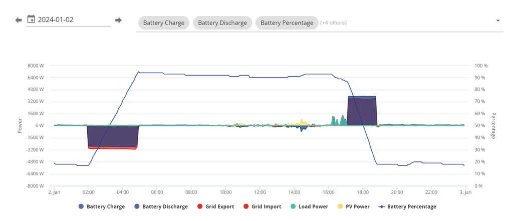

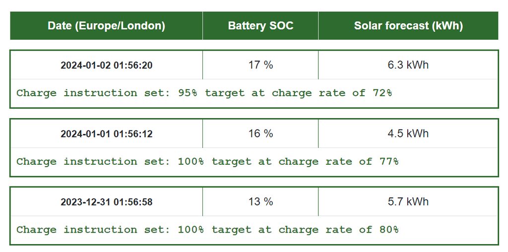

In the WW log only the charge session got actioned, but not the discharge one:
and in Giv, my previous discharge setup has continued to work as usual since WW did not overwrite anything.

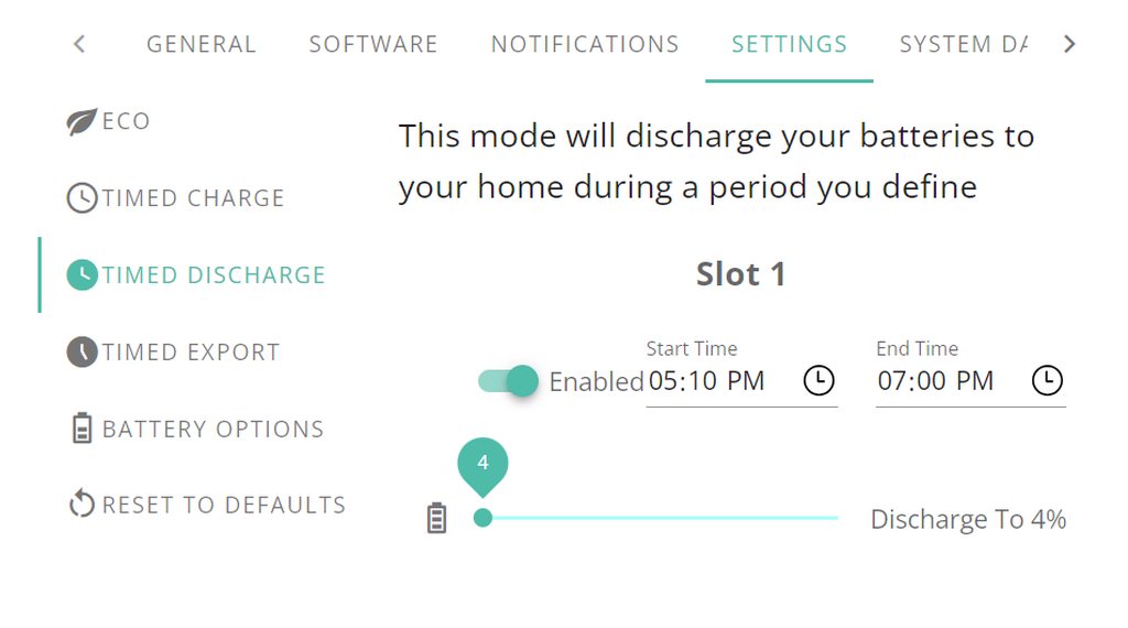

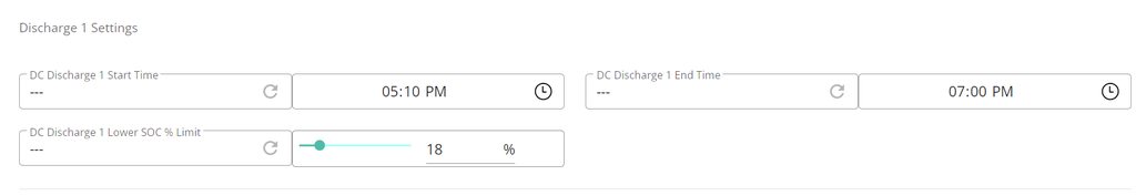

it actually stops discharging at 18%, not 4% because of the additional setting under the cogwheel in the "discharge 1" settings:
Any idea why the WW setting is not actioned ?
