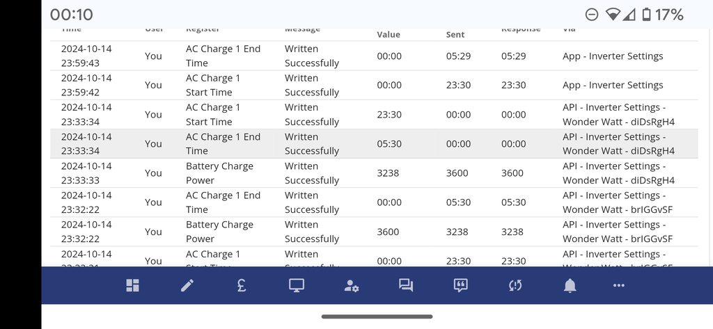

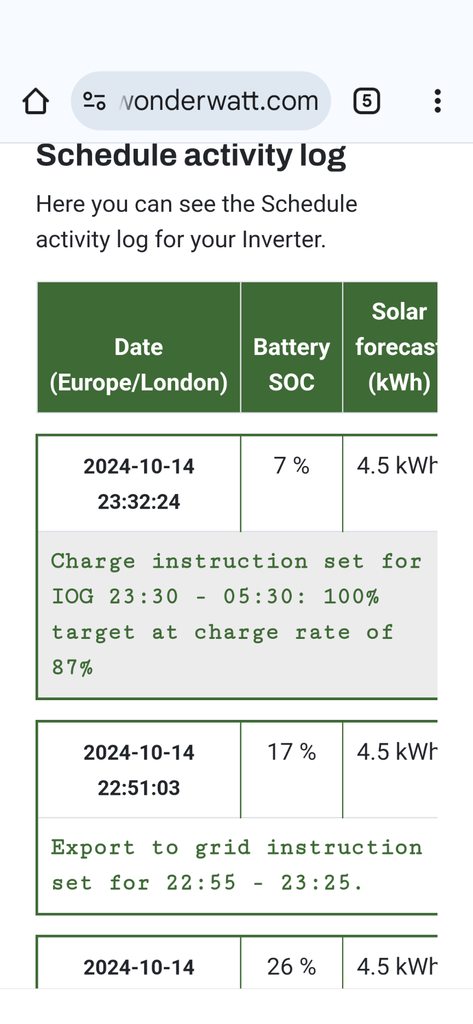

IOG charging set at 23:32, then unset at 23:33.
How has this happened?

    MrMessy Yeah - apologies, we deployed a fix (to server functions) for some other IOG functionality where users would unplug and charging would need to be stopped (as part of release 809), but need to exclude default IOG window for this and only apply when we're outside of the default IOG window.
    For now, temporarily a regular charge schedule should do.
    Fix will be ready for tomorrow...errr...today.
    UPDATE: Fixed per Release 813.

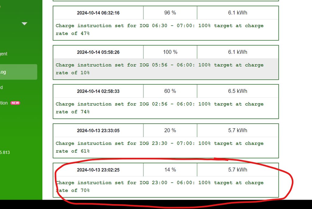

      The previous night, I had smart charging set by Octopus as 23:00-23:30 and 23:30-06:00, which was initially set by WW no problem.
      Subsequently, there's a lot of activity. Did Octopus change their mind a lot?

          admin charging was originally set as 23:00-06:00, as per the Octopus schedule I saw on plugging in but, was subsequently adjusted 4 times (inverter log confirms this).
          My batteries were fully charged, so that wasn't an issue. Just wondered if WW was reacting to changes in the schedule from Octopus that I didn't see. I know yesterday was a particularly uncomfortable day for Agile, so maybe Kracken was reacting on the fly.
            MrMessy Ah right, yeah each minute we check changes in your mapped slots. We’ll check this in more detail, but looks like Octo mapped slot changes.
