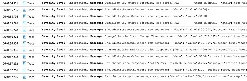

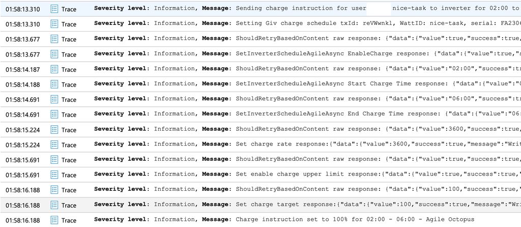

admin Crazysquares Looks like we set the charge rate as per your max, 3600, see diagnostics log from this AM, 2:00-6:00 Agile slot. And here is the end/disable instruction at around 6:00, note the discharge reset to 3600W here too.
