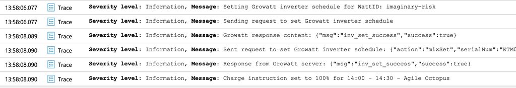

Mat I can see 3 slots. 00:00-00:30, charge instruction, 01:30-02:00 - hold instruction because your SOC less than condition on your Agile charge window is 50%, and your SOC after the first charge slot was 53%.
Same happened again on the last charge slot, 02:30 - 03:00, charge hold, because battery SOC was 53%, and is above your SOC condition for your Agile charge window.
