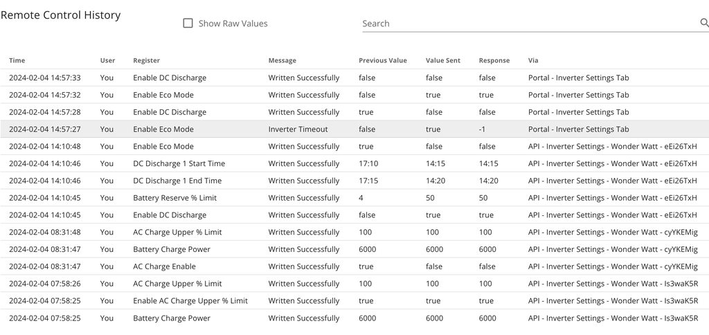

My agile charging, 4 different charge slots of varying length all worked correctly to day.
However, I did another export test. ECO came on at the end which is good, but the battery didn't export at all in the 6 minutes I set.
    Gazzagreen Right, so all looks OK, and instructions correctly sent.
    I have a sneaky suspicion that setting a 5 min export is basically not long enough for the inverter to start dumping at full rate. There might be some protection built in, in a similar way that once the battery nears 100%, the charge rate throttles down.
    Also, you may not see stuff on the app/mobile due to the 5 min refresh, which could be another factor.

    OK sent a private about this. I tried exporting for 20 minutes but the export did not start. The Eco switch in my inverter settings remained in the on position
      Gazzagreen Yeah, looks like you set export SOC requirement for export/discharge slot to be 90% but:
      It should say this in your WW activity log too.

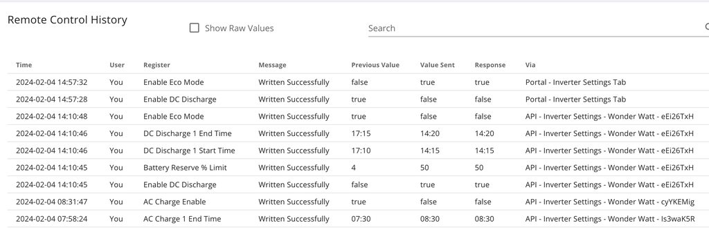

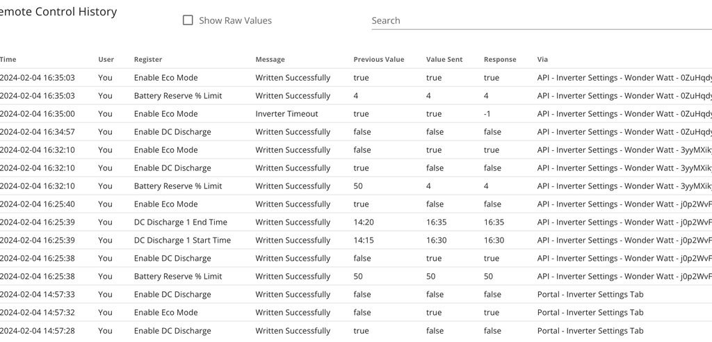

      I did another export test a short while ago. While the export started and stopped as per the settings, Eco was not re enabled and I was importing from grid to home.
        KevinD Can you send us the Giv logs please so we can look into this?
          KevinD So it looks like it scheduled it correctly.

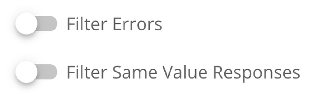

          Can you toggle these buttons off at the bottom and grab the logs again pls?
          KevinD Found an issue our end re-enabling eco after export when you have individual days selected.
