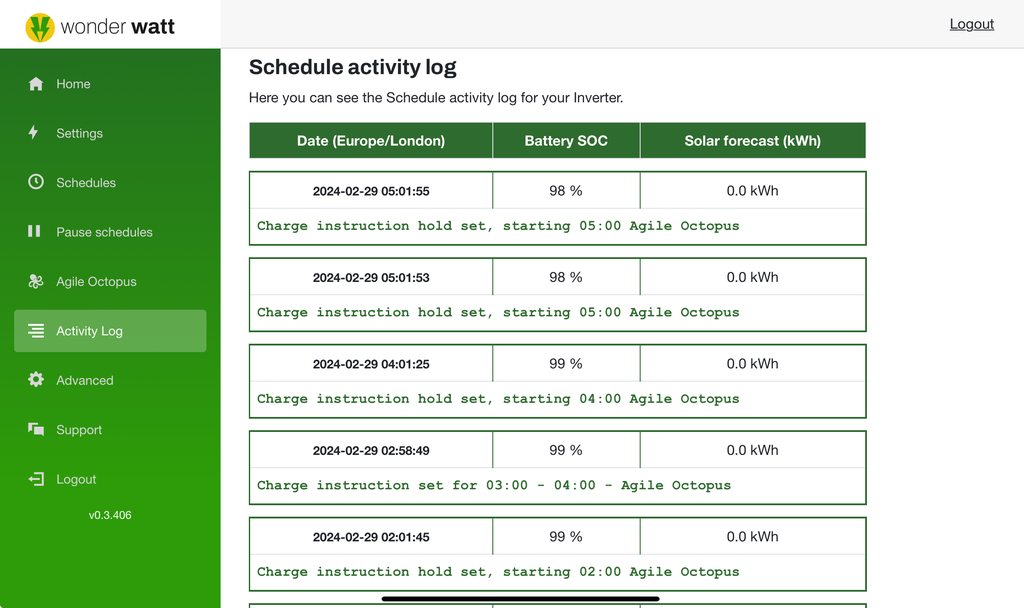

Could I request a feature to hold charge during a charge window? I've seen the hold charge between slots, but I would like it to always use grid power when in a charge window if I have selected it. So what happens is, say I set a charge window between 0100-0300 becase its 5p/KW at 0200 my battery is full so it stops charging and goes back to running on the batter for the last hour, so I don't exit at 0300 with 100% charge. However, when I set charge windows in the actual GivEnergy app, it will fill up the battery and maintain it at 100% until that slot ends. So i guess it is changing the discharge mode?
The reason I think this would need a toggle per agile charge window is because I use the usually much cheaper overnight and also have a charge before the afternoon/tea time spike in prices, here I would want it to just top it up and then go back to running off of the battery like it does now.
As always, thank you.
Jeff This is what it is supposed to do, yes.
I do think though that there is a scenario where some of this wobble still goes on due to the fact we set discharge power to 0, and depending on inverter gen etc this might not be actioned or at least there still is some discharge wobbles going on from time to time, see thread here:
https://community.wonderwatt.com/d/104-dont-use-battery-during-off-peak-setting-not-working/11
We'll be sorting out a fix for that and set the DC discharge enabled flag to false, which will hopefully sort this issue and result in a better hold-charge experience.
