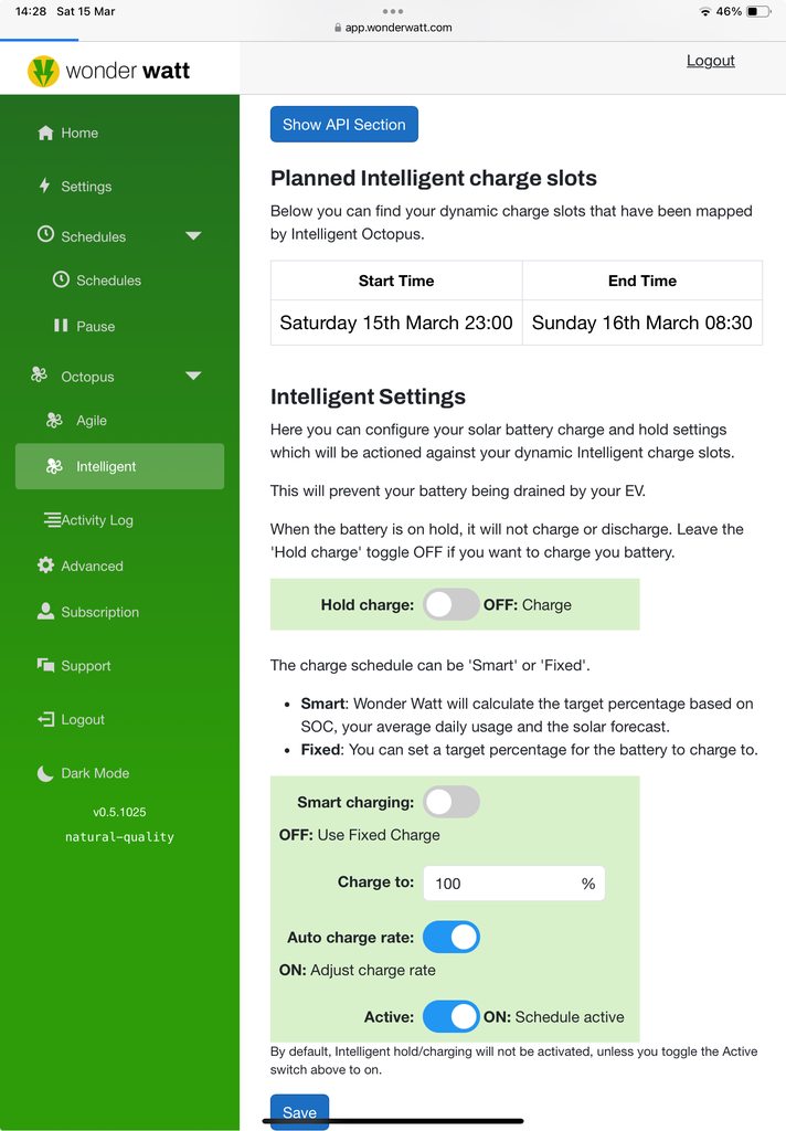

PbroJerry Should I remove any Timed Charge schedules that I currently have set in my GivEnergy Portal to avoid any conflicts with what Wonder Watt sends to my Inverter?
We use the default first Time slot and overwrite that, so any others you may have set up, it's best to disable them.
PbroJerry Do I need to set up a schedule in the Wonder Watt app or does the Wonder Watt App automatically charge between 23:30 and 05:30 based on the solar forecast?

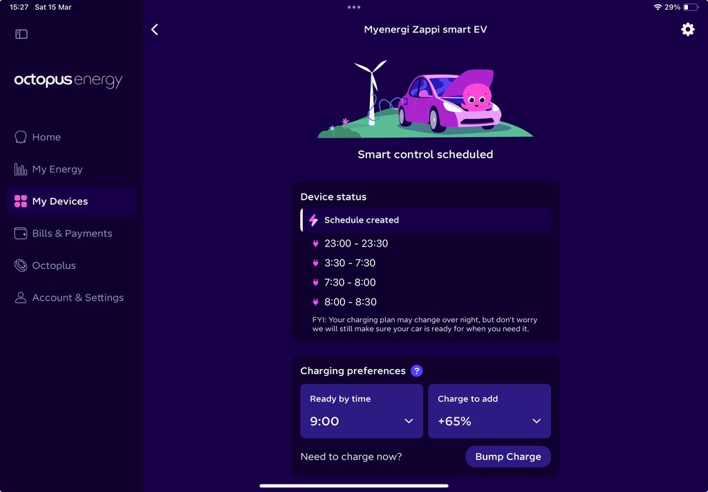

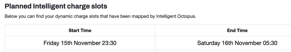

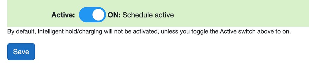

As long as you have your IOG Settings schedule set to Active, the 23:30-5:30 slot we automatically add, regardless of whether your EV is plugged in or not.
You should see the planned default IOG slot show up here:
