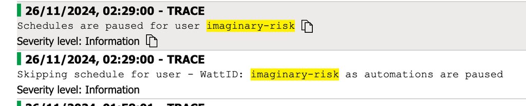

    ALLENPATTRICK The 2:30 one would have been actioned and held charge, but by then you seemed to have paused your schedules, which is why it was not actioned.

      ALLENPATTRICK just noticed that ar 2358 on the previous day that WW activivity indicated no action to a charge instruction since Soc was 100%. It seems that the Hold instruction for the schedule was then lost.
        ALLENPATTRICK Thanks for the details. We managed to track this down and it looks like there's a bug around hold for agile windows start/stop around midnight.
        Fix is currently being deployed and should be available in the next 5-10 mins.
