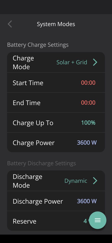

I noticed the other day in the GE app that charge was/is set to "Solar" (AC Charge Enable off) rather than "Solar+Grid".
