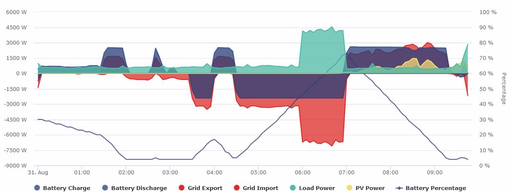

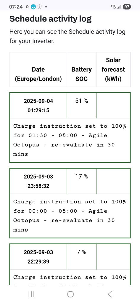

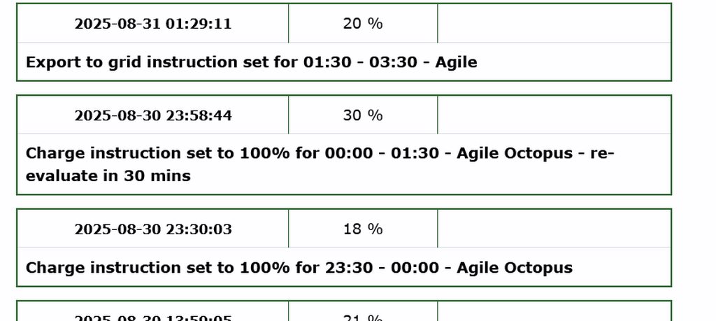

MikeC looks like there was a re- evaluation done just before midnight and charging stopped.

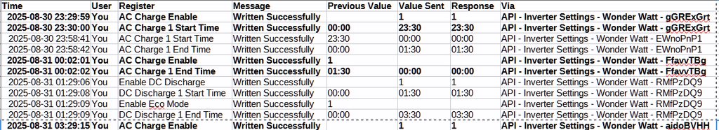

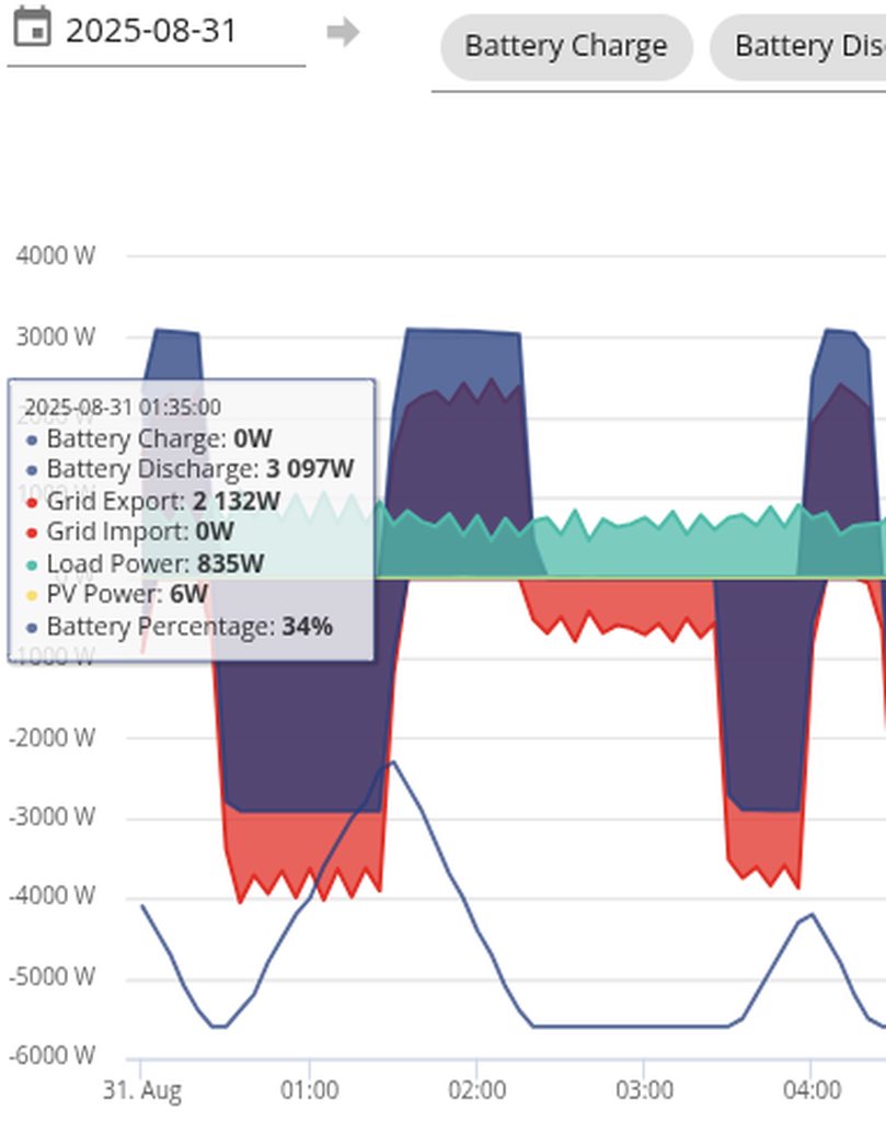

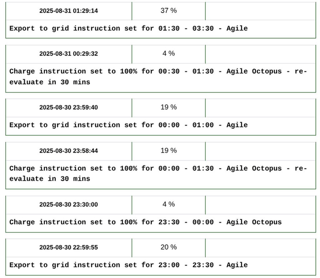

Same here. Had a charge block from 11:30pm to 1.30am. WW did commands to charge 11:30 to midnight, then commands to charge from 00:00 to 01:30 but the inverter never charged from midnight to 1:30.
neighboring-volume
Inverter = GE HY3.6 gen1
Looks like the command sent at 00:02:01 turned of the AC charge enable flag and zapped the AC charge end time :(
